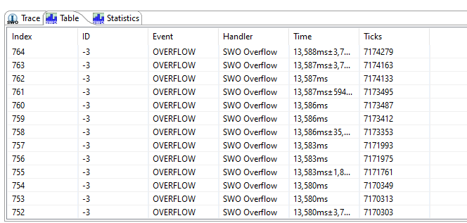

I have problems with SWO trace. The "SWO Interrupts" shows an event OVERFLOW within the "Table" tab continuously as shown in the following picture. pastedImage_1.png
Why does SWO overflow occur so often? I also get many wrong interrupts within the "Statistics" tab. These are Interrupts that i never use in my project.

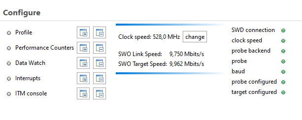

It seems to me the SWO configuration is correct when I download my firmware with the debugger.pastedImage_2.png
I am using iMXRT1050 with a custom board and LPC-Link2 and i apply the configuration according to the following link.
SWO with NXP i.MX RT1064-EVK Board
My MCUXpresso version is MCUXpresso IDE v11.1.1 [Build 3241] [2020-03-02] and the used SDK version is SDK_2.x_EVKB-IMXRT1050.

Hello Sabina,
I found another tutorial that describes SWO trace Tutorial: Using Single Wire Output SWO with ARM Cortex-M and Eclipse | MCU on Eclipse.
I have adapted to my application and it works.

Sabina_Bruce
Hello Patrick,
Hope you are doing well.
Since you are working with a custom board it will be difficult for me to pin point the issue right away. I'd like to be able to reproduce this on my end, but I have the evaluation board. Do you have an evaluation board that you can reproduce this error?
Are you basing this test on an example from the SDK?
