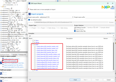

I'm trying to configure IMXRT1170 as slave for to master which is different MCU (not nxp product) of M4 core.
What is basic step to do to config the as SPI slave?

Hi @KAVIN_M ,
I suggest you can refer to NXP SDK demo.
There are several drive ways, It depend on your needs.

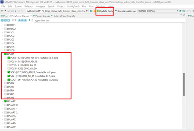

For example, You can refer to SDK demo "evkbmimxrt1170_lpspi_edma_b2b_transfer_slave_cm7",  If you want set SPI pin ,you can use Config Tool.
Finally, please double check that the Clock polarity and Clock phase settings of the SPI slave device are consistent with those of the master SPI.
