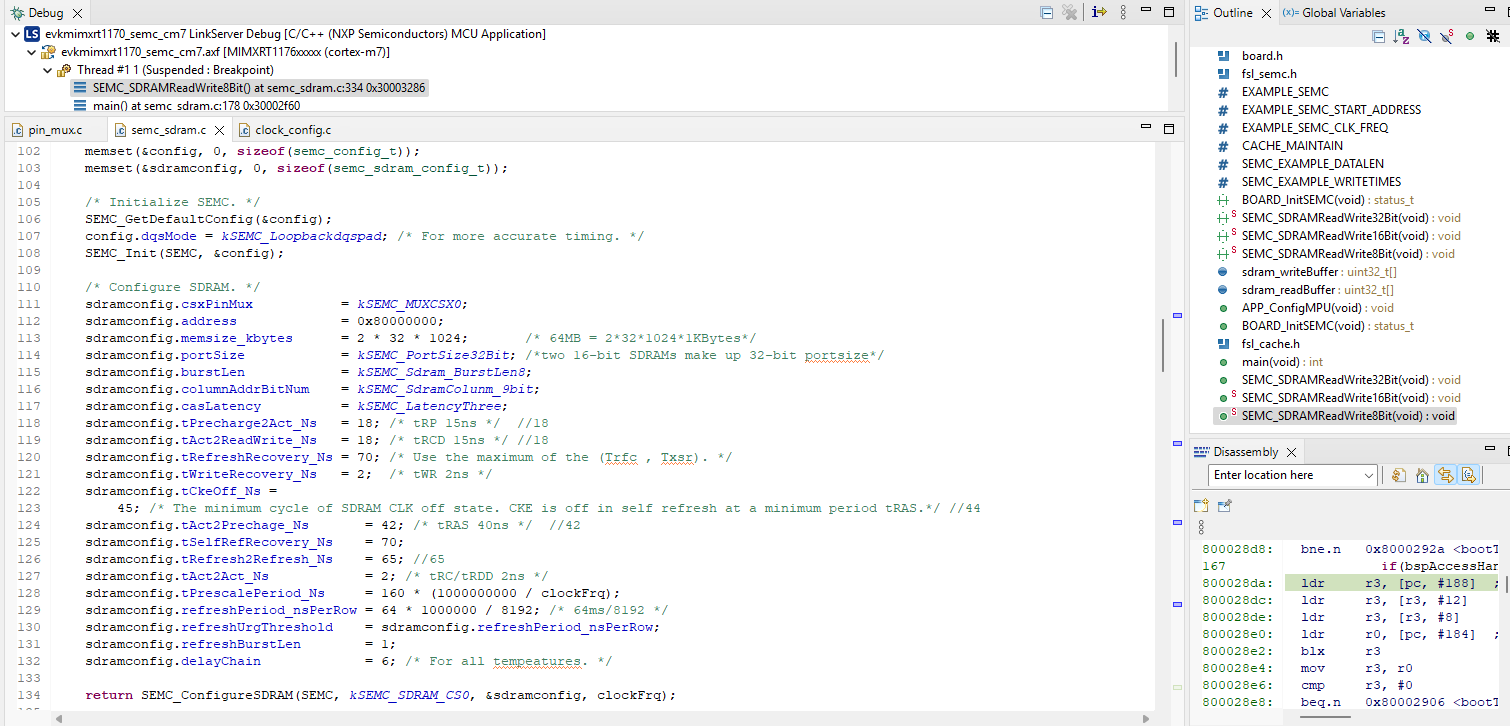

I have one SDRAM (IS42S32800G-6BLI) that I am using with IMXRT1176 chip.
Even though IS42S32800G-6BLI SDRAM supports max 166MHz Clock, I can run it with 221MHz clock or 198MHz clock or smaller than via SEMC Interface.

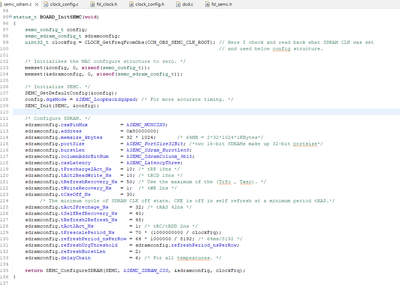

I tested the scenario with "evkmimxrt1170_semc_cm7" example in SDK 2.14 with MCUXPRESSO IDE.
Attached is the SDRAM clock speed and configuration of SDRAM paramaters. I also attached debugger results to be your sure that I applied the example correctly to my custom board.

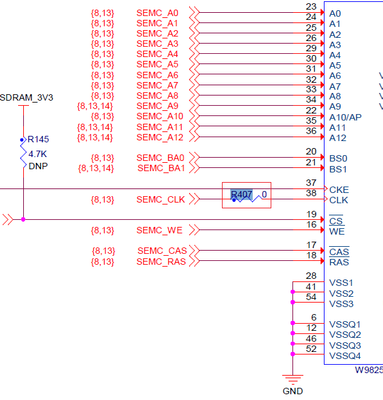

I also tested the same example with EVK-1170, yet it gives the same result. It works every CLK freq greater than its SDRAM chip(W9825G6KH-5I).
I am really confused how SDRAM runs over its maximum speed 166MHz. There must be something wrong. However, I could not figure it out.

Hi @mayliu1 ,
Actually, SEMC timing paramaters has no effect. Changing timing paramaters has no effect in terms of SDRAM working.
I set all SEMC timing parameters according to the SDRAM’ own datasheet. Later than I realized that SDRAM works with nearly every random SEMC timing parameter value. Whatever values I try to write there, example always run successfully.  Please look at the SEMC timing values difference in configuration attachments between my first post and second post. They are completely different. However, it still keeps running. I think this is unexpected result for me. Is this normal behaviour?
@mayliu1, If you have any eval board, please try to enter different timing values than the ones in its datasheet and observe the result. Also please try to set its CLK freq higher than SDRAM max CLK speed. You will understand what I mean.

I performed the SDRAM CLK measurement by oscilloscope.  Attached below there are 2 different short videos. One is SDRAM CLK is adjusted as 264MHz and another video is CLK as 221MHz.
As you noticed in the videos, both are run by success. Also I captured both CLKs with oscilloscope to prove it was set by software.
One other important finding is that as you see in video,  sdram_config structure runs perfectly directly on EVK-MIMXRT1170 eval board. As you see, I used nearly all members of structure with wrong values according to the EVAL BOARD SDRAM datasheet(W9825G6KH-5I).
So how is this possible? SDRAM CLK and Config values does not have any impact on SDRAM workings as you see. I really wonder how it runs well although completely error parameter values?
One last interesting is that I also measured my custom board SDRAM CLK with oscilloscope. Again even though it is max speed 166MHz according to its datasheet, it runs well with 198MHz clock. I proved it by measuring oscilloscope as well.

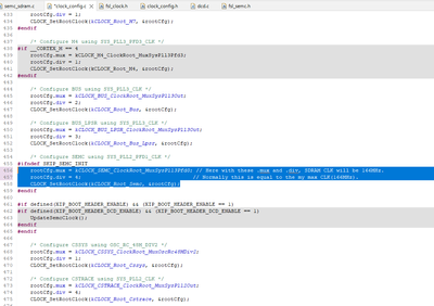

I wonder how you set CLK as 216MHz or 220MHz. As far as I know every CLK speed is not possible to adjust. There are some Clock Sources and Div paramaters for that purpose.
Also what about the other parameters in that Sdram_Config structure? I randomly give different values from its typical values in its datasheet. However it works with any values no matter what I put there? How is this possible? As I know, entering all paramaters values are critically important for SDRAM to work well.
As I see in your post, you simply write 220MHz to CLK variable? If it is, then I think, it is not true way to set CLK.  So simply writing any value to Clock variable does not point it is set. You tried to adjust 220MHz in wrong place.
I was set it with Mux and Div members inside Clock_Config.c file. You can see the place where I am setting it in my first post attachment.

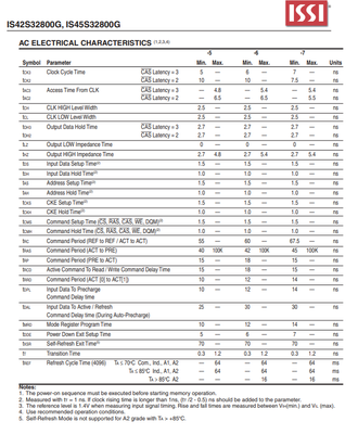

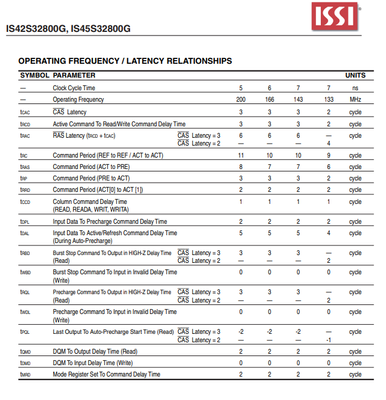

I am already aware of below 3 frequencies of SDRAM. Not new information for me. I say that Whether entering datasheet values or not does not make any difference. That is all what I am trying to explain.
Please look at the below part of my current SDRAM datasheet.

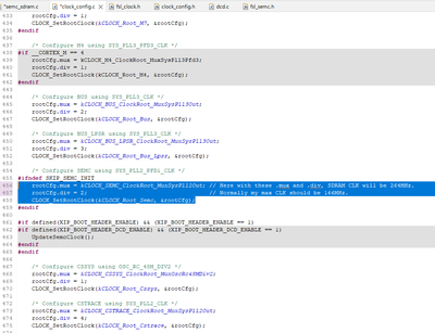

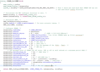

Please look at the below my settings; In first Screenshot, I filled all the parameter values as based on above datasheet. Also please look at how I am setting its clock(166MHz). See below carefully please.
However, here is my SDRAM CLK setting and other structure values that I wrote. Also please look at how I am setting its clock wrongly on purpose(221MHz). Normally, I expect my SDRAM example not works correctly. Because, as you see in below, all settings are intentionally typed as wrong. Even with below incorrect settings, example still runs successfully without error. So how? I do not understand which specifications I follow?
You can type something different values to every member of above structure. And you will see that nearly all settings fits perfect and works successfully. That is why I concludes that following SDRAM datasheet and IMXRT1170 specifications makes no difference in terms of its right working conditions. How?

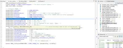

Please look at below SS;
While my SDRAM clock frequency is set to 221MHz, I changed the structure parameter values randomly for SDRAM configuration. I randomly give numbers to the some of elements of structure. It works every value no matter what value I put there.
Only when I change the .casLatency parameter value from "kSEMC_LatencyThree" to "kSEMC_LatencyTwo", it did not work as I expected. Apart from that; changing any parameter value seems that it takes no effect in this structure, example always works successfully.
So seemingly, there is some piece of code elsewhere beyond our software control to configure SDRAM at initialization. I could not understand how I manage SDRAM with my own values.
