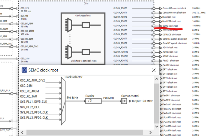

Hi team,
Please respond it is urgent.
We are working on imxrt1176 with SDRAM test code
Could you please confirm that event if DCD and clock_config.c and ,h are having changes for new frequency 133mHZ/166MHZ?
and run a sample code of evkmimxrt1170_semc_cm7, effective frequency will be based on settings written in
status_t BOARD_InitSEMC(void)
semc_config_t config;
semc_sdram_config_t sdramconfig;
uint32_t clockFrq = EXAMPLE_SEMC_CLK_FREQ;

return SEMC_ConfigureSDRAM(SEMC, kSEMC_SDRAM_CS0, &sdramconfig, clockFrq);
if so what will be the settings for 133MHZ and 166MHZ SDRAM frequency?

Hi @anasnadukkandiyil ,
DCD can set clock but BOARD_InitSEMC() can't. DCD is configured in dcd.c. When compile, it will be put in image header. The bootROM can read DCD sector and configure SEMC and clock.
BOARD_InitSEMC() can overwrite SEMC settings but not clock. The SDRAM clock is set in clock_config.c. SDRAM operation speed is same to SEMC clock root.
This picture is copy from MCUXpresso config tool. You can use it to config SDRAM clock easily.
Jing
