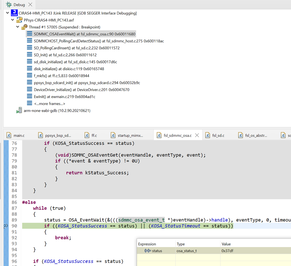

 My SD card works until certain functions are called which attempt to re-init the card and do card detect. E.g, f_mkfs(). When this happens it gets stuck in a loop with OSA_EventWait() coming back with KOSA_StatusIdle over and over.
f_mkfs() WILL work if I never call f_mount(). However, unmounting does not rectify the situation.
I should add that, with our PCB, an SD card will always be present. I'd like to forgo the check altogether really.
#define BOARD_SDMMC_SD_CD_TYPE kSD_DetectCardByHostDATA3
sdcard_fatfs_instance_t g_SDcardFatfsInstance is in non-cached sdram.

When f_mount() initially succeeds in detecting the card SDMMCHOST_CardDetectStatus() calls "USDHC_GetPresentStatusFlags(host->hostController.base) & (uint32_t)kUSDHC_CardInsertedFlag)" and the USDHC->PRES_STATE CINST bit comes back as set. As it should.
But when an f_mkfs() follows f_mount() and f_unmount() the CINST remains unset.
I'm aware of the following comments:
" * Note: Please pay attention, DAT3 card detection cannot works during the card access,
* since the DAT3 will be used for data transfer, thus the functionality of card detect will be disabled. Using card
* detect pin for card detection is recommended."
...and..
"PRES_STATE CINST [...] This bit indicates whether a card has been inserted.[...]The Software Reset For All in the System Control register does not effect this bit. A software reset does not effect this bit."
...but does this also implicate that once data transfers are done no amount of resetting and re-init will ever get DAT3 card detect to work again???

This is correct. DAT3 line is configured as card detection pin for 1-bit mode, once 4 or 8 bit transfer transfer is being done it won't be able to detect a card. Additionally, the register will not update unless the card is removed and reinserted or after a POR.
