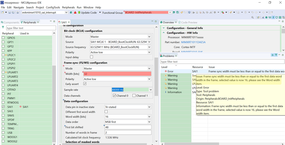

We are in a situation where we need to use 32 bit wide frame sync (as this is the format that the codec expects), but the audio data itself is in 16 bits/frame format. I assumed that this configuration would be possible to manage in the SAI, by configuring the Frame Sync width to 32 bits, and the data word widths to 16 bits. The MCUXpresso Config Tool however marks this as an invalid setting.
Could someone tell us if this configuration is possible to achieve with iMXRT1010 SAI, and if so, with what configuration settings? I'd also like to know what should be the correct First Bit Shifted value, in order to shift the 16-bit data to the highest 16 bits of the frame.

We're using MIMXRT1011 chip. Here's the screenshot of the configurator showing the erroneous setting (and also the tool versions):

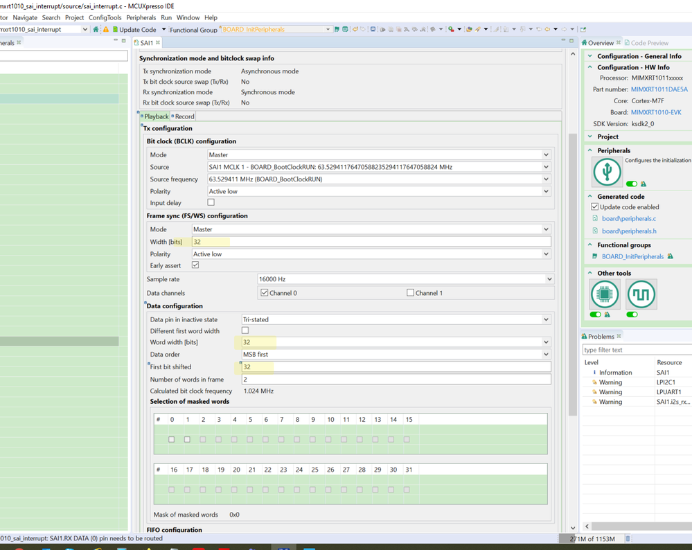

Hi benedek_kupper,
  So sorry for my later reply, because of our Chinese National day from 10.1 to 10.8, today we are back to work, and I check it on my side, please configure it like me, do you still have issues?
Wish it helps you!
If you still have questions about it, please kindly let me know!
Kerry
5,008 Views
benedek_kupper
Your configuration is for transferring 32 bit samples, but I have 16 bit samples, so I cannot use this configuration. (It would result in two samples being merged into one.)

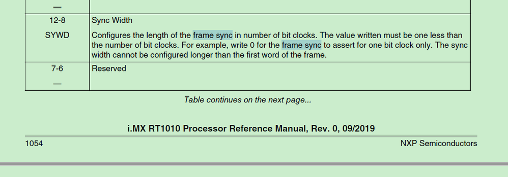

kerryzhou
Hi benedek_kupper,
   If use your configuration, I find it has the issue like the following:
Frame sync width must be less than or equal to the first data word width in the frame.
In the RM, TCSR[TE] register:
It also has the first word sync width limit.
So,I think your this type configuration is not supported by the RT1010.

benedek_kupper
In the meantime we have managed to make it work as we need it:
  1. We keep the widths at 32 in the configurator, and change the first bit shifted to 48 (it should be 16, as we're shifting up the 16-bit samples to the MSB, but that value isn't allowed, it works with 32+16 though).
  2. Then we need to manually change the sai_edma_handle_t's bytesPerFrame to 2 (which is sizeof(uint16_t)) after calling the peripheral init function.
I hope this will help fellow developers until the drivers/configurator is updated to support this mode.
