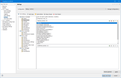

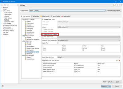

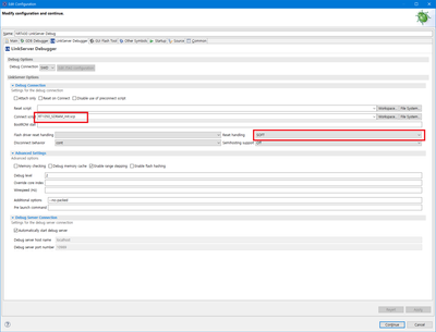

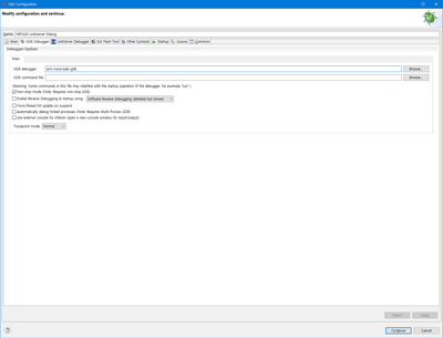

I'm using RT1050 mcu, MCUXpresso 11.5, sdk 2.11.1 and FreeRTOS
I'm trying to use this device in various cases, I've successfully compiled and debugged a project running in flash.
Now I'm trying to do the same thing in external SDRAM, but with no success.
I've modified the project settings:
abs_setian_1-1709710388080.pngabs_setian_1-1709710388080.pngabs_setian_2-1709710413550.pngabs_setian_2-1709710413550.png
abs_setian_3-1709710501110.pngabs_setian_3-1709710501110.pngabs_setian_4-1709710514691.pngabs_setian_4-1709710514691.png
From the console debug messages it seems that the program can't access memory.

Hi @abs_setian,
Please follow the following knowledge base article to execute a mass erase and recover debug connection with the core: RT board recovery for debugger connect issues - NXP Community
Then, you can follow this other post to generate an image executable by RAM: Generating a Bootable Image for the RT1050 - NXP Community
Let me know if it helps!
