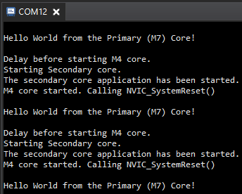

  Do you call  NVIC_SystemReset() in your M4 core or M7 core code?
  You can add the print information in the different core, then in the M4 core code add the reset, whether your M7 core also reset from the print log?
  Please help to confirm the question at first, thanks.
Kerry
1,652 Views
D_TTSA
Contributor V
Hi @kerryzhou
Yes, I am calling NVIC_SystemReset() on the M4 core.
I have indeed confirmed that both cores are reset by this call. Please see the print log below:
