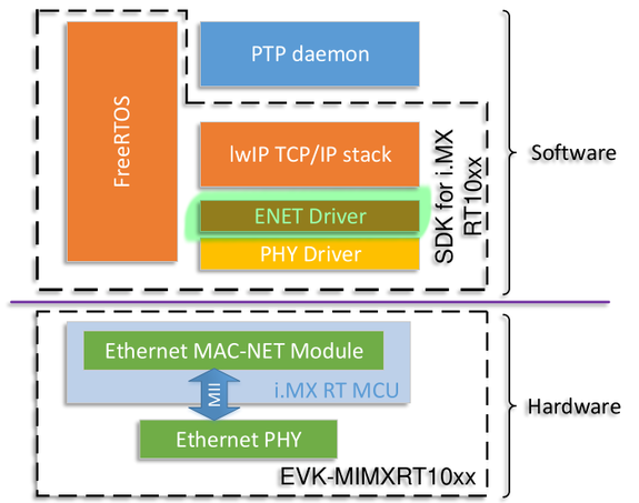

I’ve been working with the application note AN12149 ("Implementing an IEEE 1588 V2 on i.MX RT Using PTPd, FreeRTOS, and lwIP TCP/IP stack") published by NXP in 2018. While it’s a great starting point, it’s severely outdated:
  • It relies on SDK 2.4.x (current version is 2.16.100, which is vastly different).
  • It uses FreeRTOS 10.0.1 (current version is 11.1.0).
  • It uses a patched version of lwIP 2.0.3 (current version is 2.2.0).
  • The PTPd version is 2.2.2, heavily patched to run on a microcontroller. This project, originally POSIX-based and designed for Linux, isn’t well-suited for microcontroller environments. It requires significant memory (both code and data) and isn’t particularly optimized or efficient.
The example is also limited to the RT1020, RT1050, and RT1060. We managed (with considerable effort) to port it to the RT1170, but we’re still struggling to get 100M Ethernet working reliably.

Can update you on a problem that we are definitely experiencing. In some scenarios we detect packet leaks. We are pretty sure that it is the SW that is “losing” these packets. I say this because we are talking about RTP packets containing audio samples, so we can hear by ear the lost packets, plus the packets are tagged with progressive numbers, so it is easy to realize lost packets (never arrived, even out of order).
In addition, there are other devices in the same network that receive the same audio stream and have no problem. So we know that on the network the packets are all there.
Finally by querying the ENET devices and the PHY no reception problems are found. So the packets should all be received, and therefore it must be the SW that loses them.
I would remind you that the current driver code is the result of a porting that itself was already a porting. So if I had to bet on where the problem might be, I would bet on the component highlighted in green:
We have been trying to get to the bottom of this problem for a few weeks now, without any kind of success, and I make no secret of the fact that the updated code of AN12149 would be like a ray of light.

As I have already written, we developed our entire SW stack on an RT1051, “roughly” bringing in patches from AN12149's SW.
We “reinterpreted” the patches and had to slightly patch the ENET driver as well.
Things seemed to work well, though. Our products are amplifiers that play audio from an RTP packet stream (in AES67 standard). And on these we haven't had any major problems so far.
Then we approached the RT1170s. The ENET device IPs (I'm talking about the 10/100) is the same as the RT1051. And in fact the driver on SDK is the same.
We had to reinterpret the patches further, though.
What we observe is that in the RTP stream (one packet every millisecond) we occasionally lose some packets, up to a few dozen per second with non-constant rate.
Of course we do the tests side by side with devices with RT1051, which have no problems.
Right now the main suspect is the patches we made (to be precise, it's the interpretation of said patches that is under investigation).
The first patches though were made by NXP in AN12149, and this prompted me to ask for an AN update to support newer microcontrollers and perhaps find (or write from scratch) an alternative to PTPd, which is an extremely inefficient piece of SW, both in terms of machine cycles and memory footprint.

Thanks for your reply and your curiosity about the Ethernet issues with the RT1170. Let me explain briefly the challenges I’m facing:
I'm curious about the Ethernet problems you're having with the RT1170
To make PTP work on the RT1170, I first need to figure out which patches were applied in the 2018 example. This is already a daunting task because:
  • It’s unclear which files from the 2018 example were modified.
  • There’s no precise information about the exact SDK version NXP used. I’ve found SDK 2.4.0, 2.4.1, and three different releases of 2.4.2, but I don’t know which one served as the base.
Even if I manage to understand the required patches, applying them to the newer SDK is a completely different challenge. The file structure has changed significantly. For instance, the file enet_ethernetif_kinetis.c, which is critical for Ethernet management today, didn’t exist in the older SDK. And it is not the only example.This means I can’t simply patch the code; I have to manually adapt it, which increases the likelihood of errors.
And that is only considering the SDK, then there would be to consider all the middleware (lwip, freertos, etc.) and not least PTPd
