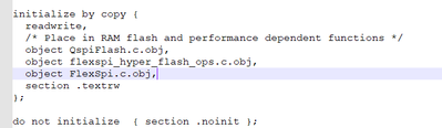

We are taking reference from example Hyeperflash with SDK_2.9.1_EVKB-IMXRT1050\boards\evkbimxrt1050\driver_examples\flexspi\hyper_flash\polling_transfer.  This example we have modified for external QSPI interface with flexspi using Linker file MIMXRT1052xxxxx_flexspi_nor.icf.
We have modified linker file to work this as below,
With above changes Read and write from external Nor flash connected with FLEXSPI is working on IAR IDE. But same change we have ported to eclipse with cmake but it is not working seems when we try to configure FlexSpi register then system crashes.

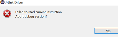

We have modified FlexSpi NOR linker file. We are using eclipse IDE with Cmake. Here Qspi.c is calling some API from FlexSpi.c. We have seen QSPI and FlexSpi object file is correctly moved to RAM location. Now FlexSpi Initialization is successful without any crash. But when try to read Device ID of QSPI it hangs on API  QspiFlash_GetVendorId(..).
Linker file modification :

QspiFlash_GetVendorId(&vendorID); // This is defined in QspiFlash.c // **It shows below message
When I stop debugger it shows below message in disassembly when it JUMPS to NOR location.
Please let us know where is the issue?

jeremyzhou
Thanks for your reply.
As the below figure shows, the QspiFlash_GetVendorId() function still resides in the QSPI instead of the RAM actually, and it's the root cause of the above failure.

shaileshnsec
I have checked API QspiFlash_GetVendorId(..) is located to RAM location as well. I have attached screenshot(Intentionally called before to QspiFlash_Init to verify whether it enters to RAM).
Problem is when QspiFlash_Init() API is called, seems it does not comes out of RAM location correctly. So it does not go inside QspiFlash_GetVendorId() and show below message.
More information on relocation from RAM to NOR and Vice-versa.
Please let us know where is the problem??
