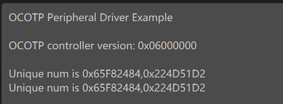

I am trying to read the unique ID on i.MXRT RT1050. First I read it like below:
uint32_t id1 = OCOTP->CFG0; uint32_t id2 = OCOTP->CFG1;
Then, I found in the forum that the right way to do so is:
OCOTP_ClearErrorStatus(OCOTP);
OCOTP_ReloadShadowRegister(OCOTP);
uid_read_data[0] = OCOTP_ReadFuseShadowRegister(OCOTP, fuse_address[0]);
uid_read_data[1] = OCOTP_ReadFuseShadowRegister(OCOTP, fuse_address[1]);
However, the second approach gives me only zero while the first one gives something more meaningful. Could anyone please tell me why reading directly from the register is not right, and why the second method does not work properly?

I adapt the evkbimxrt1050_ocotp_example demo in the SDK library and run it, I find these two approaches both can get the unique ID successfully.
I attach the test result below and the attachment is the demo code, please give it a try.

Thank you so much! I realized that I did not initialize OCOTP in my code.
