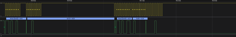

I have a system based around the MIMXRT685-EVK running Zephyr.  I have the i3c port configured and interfacing with a few i2c devices.  They all work for some time, but depending of frequency of communication the bus/driver will just die after a few minutes.
I experienced this on the evk and on our custom board.  And similarly with all the peripherals on the bus or just a single one.

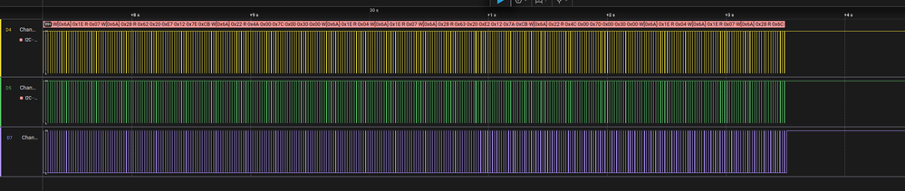

here you can see the scope (yellow SDA, green SCL, violet device interrupt) it just stops trying any comms on the bus when it should be servicing the interrupt:logic outputlogic output
It happens for this device which is imu - lsm6dso (a zephyr built in driver), sampling at higher frequency from interrupts. Even communicating with another device at slower frequency it will stay up longer but eventually crash (maybe 5-10 minutes with a polling message every second).
Here is the warnings we saw from the i3c_mcux driver just before the bus goes dead.  the errors are failed attempts to read from device registers (the bus in the scope has no activity from subsequent attempts, shown in red as errors):
warning from i3c_mcux before bus crashwarning from i3c_mcux before bus crash
Has anyone seen any issues similar with the i3c bus and zephyr implementation specifically?
our whole bus is essentially i2c devices we don't need the features of i3c (we are using it because we are using all the other ports) if there is a way it might be more stable if we "force" it into i2c mode all the time?
It don't know if there is a bug in the driver or some way to better configure it?  we are using it pretty much as it came.  see device tree sections:

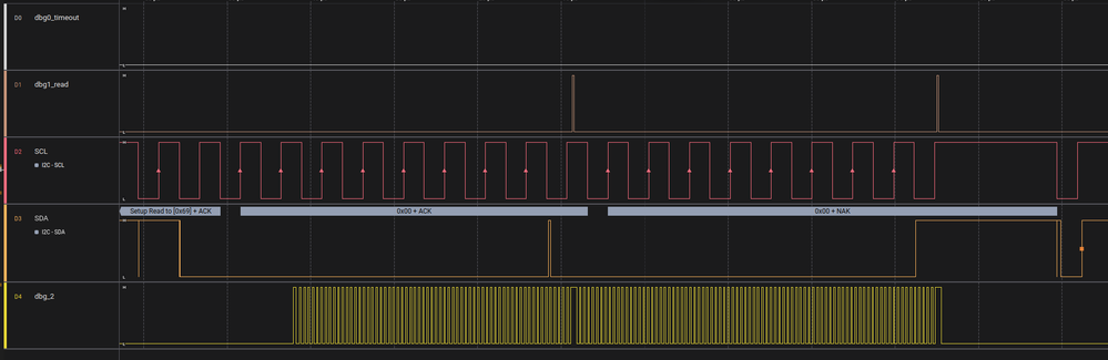

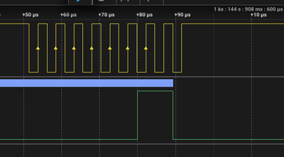

Regarding debugging timeout, I am thinking that, can you use gpio toggling instead of calling LOG_DBG or LOG_ERR printout when time out occurs?
GPIO1 toggles when timeout in MSTATUS and GPIO2 toggle when MRDATAB is read from the register, you can trigger on edge of GPIO1, the I2C SCL and GPIO2 should be sync well that Data is read on the falling edge of the SCL.
If there is a long delay that data is not read on MRDATAB after SCL is low, there is something wrong in your app.
3,154 Views
galenc
Hi @Dezheng_Tang I setup the debug outputs as suggested.  I also added a 3rd GPIO into the attempted read loop.
I made the changes as follows:
static int mcux_i3c_do_one_xfer_read(I3C_Type *base, uint8_t *buf, uint8_t buf_sz, bool ibi)
	int ret = 0;
	int offset = 0;
	while (offset < buf_sz) {
		 * Transfer data from FIFO into buffer. Read
		 * in a tight loop to reduce chance of losing

Here is a good read:
good readgood read
Here is a time out where no data was actually read:
timeouttimeout
Timeouts will happen when 0 reads actually happen or sometimes 1 will be read or sometimes even both.  But it looks like that function in the driver is taking too long to read from the FIFO, perhaps a context switch from zephyr has occurred. I haven't caught the error yet that takes the bus down.

Here is a plot of the bus as it dies on our custom board (the lines are steady state like that forever, i.e. SDA low and SCL High):
3,101 Views
Dezheng_Tang

I cleaned up some of the logging but looks like the issue still follows that wave form.  the SDA is low and does not return high.  In this plot only after i reset the target twice does it recover:
A closer look at the "pulse" in the middle (the first time I press reset):
Zephyr actually cannot get past pre-main init code with the first reset.
The bus only recovers after the second reset, when SDA finally transitions high.  What could cause the SDA to be held low like this?  We have multiple pull-ups on the lines, so something must be driving it low.  Do you think your suggestion of switching to GPIO mux and toggling will resolve this?
