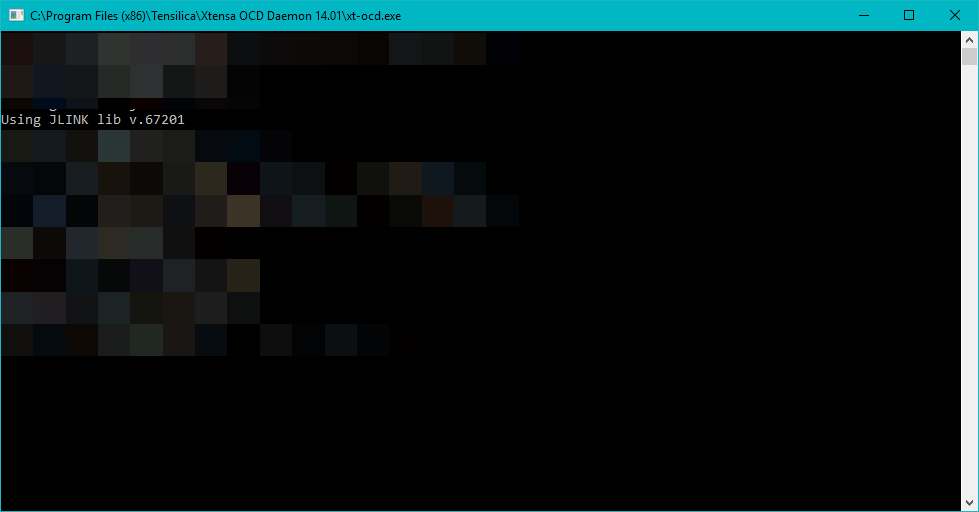

zhang2018tz
My on board debugger was programmed to Jlink by LPCScrypt_2.1.1_15.exe, as instructed by the "getting start" doc. After running OCD, it shows: Jlink Lib V.66204
Where does your Jlink 6.72a come from? Maybe I should find Jlink 6.72a? 未标题-2 拷贝.jpg

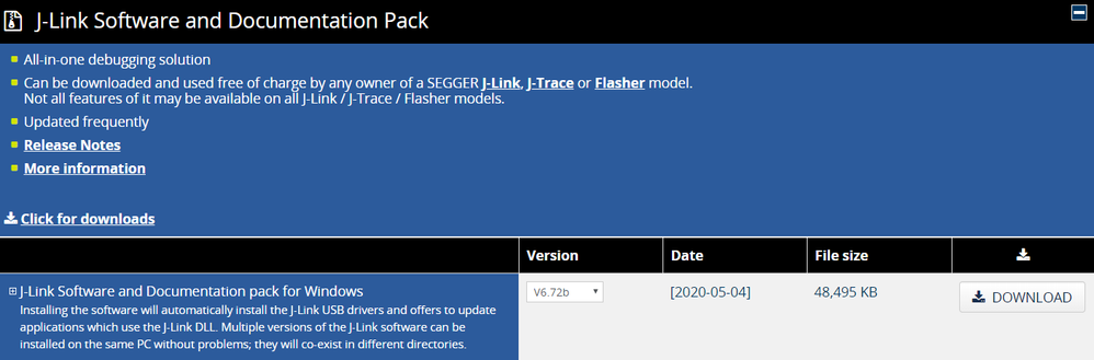

victorjimenez
Please download and install the latest version available of the JLink software from the following link: https://www.segger.com/downloads/jlink/#J-LinkSoftwareAndDocumentationPack
After installing the newest version, when you run the OCD you will see something like the following:
Please let me know your results once you try this.
Victor

zhang2018tz
Hello Victor, thanks for your help. I downloaded the latest Jlink software, and now I have JLINK lib V.67202 activated. But this doesn't help me. I am still having 40 seconds downloading mu-interrupt demo on win7, and 11 seconds downloading mu-interrupt demo on win10.
stepping signle line over is still slow. (1~5 srconds).
