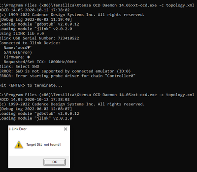

I'm trying to bring up the RT685 board for running DSP applications. I'm following the guide at: https://www.nxp.com/document/guide/getting-started-with-i-mx-rt600-evaluation-kit:GS-MIMXRT685-EVK#t...
I can successfully build and run the Arm application from MCUXpresso.
But get this error when running the Xtensa OCD Daemon application.
I have confirmed that the serial number in the topology file matches that of the LPC-Link2.
When trying to run the jLink DLL updater no application are ready for update.
Hope someone can help me get it to work, please let me know if more information is needed.
Setup:
PC with Windows 10
MIMXRT685-EVK
MCUXpresso v11.5.1
Xtensa OCD Daemon v14.05
Xtensa Xplorer v8.0.15
Best Regards
Mikkel
3,129 Views
mhp
Solved - Needed to run the command prompt as administrator.
