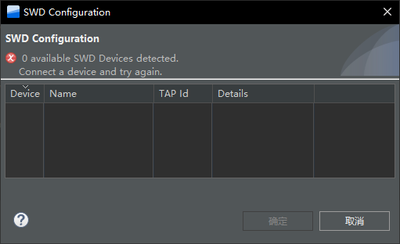

RT1180 EVK onboard MCU-Link debug 0 available SWD Devices detected.
407件の閲覧回数
ethan_dang1
When I try to debug with RT1180 EVK onboard MCU-Link, I get the following error, JP5 not shorted
I had try to use NXP-MCUBootUtility for chip earse in SDP mode, However, the following error will still occur after the successful erase and switching to qflash boot

ethan_dang1
Hi @ethan_dang1 ,
I also found that using IAR allows for normal debugging using the on-board debugger. The version of MCUXpresso IDE I am using is v25.6.136. It is also possible to debug normally using an external Jlink in MCUXpresso IDE.

ethan_dang1
Hi @mayliu1
Thanks for your reply.
I have refer to this file, now JP4 and JP5 are open, The LEDs status is also normal
But after clicking "debug", the issue still occurs.
