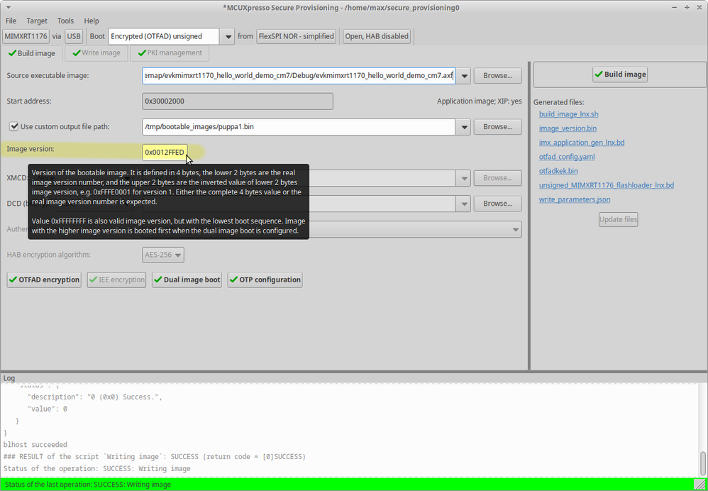

I am trying the "dual image" feature on RT117o EVK.
On Provisioning tool there is Image version field:
in the popup it says: "Image with the higher image version is booted first".

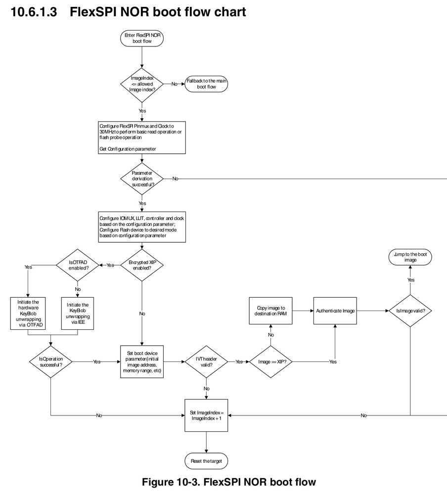

This is openly at odds with flowcharts:
point me to the section in the Reference Manual or Security Reference Manual where this feature is detailed?

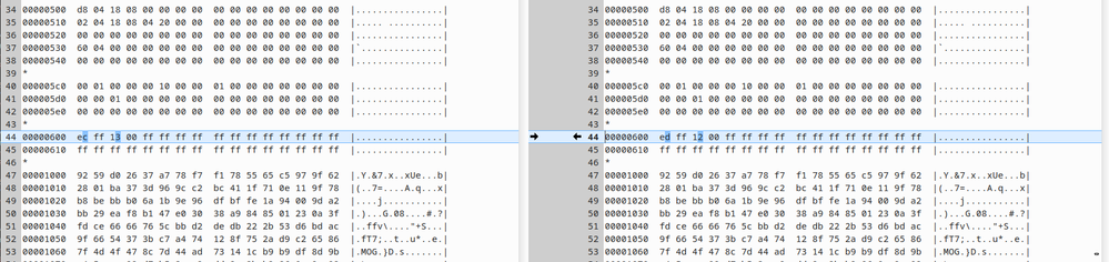

However, I also tried (see attached project):
  • both images have the same version: I can jump from one to the other and it always starts image 0
  • image 0 has 0x0012FFED, image 1 has 0x0013FFEC: both images can jump into the other, image 0 always starts
  • image 0 has 0x0013FFEC, image 1 has 0x0012FFED: always starts image 1 and fails to jump to image 0.

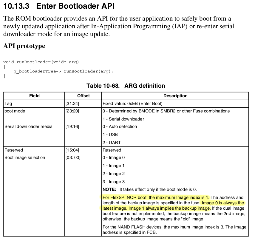

Can you explain this strange behavior? Or maybe you can point me to cove this feature/behavior is documented?
regards
Max
967件の閲覧回数
RaRo
Hello @mastupristi,
Could you please take a look at the i.MX RT1170 Processor Reference Manual. Section 10.13.3 Enter Bootloader API or Security Reference Manual for the i.MX RT1170 Processor. Section 2.13.3 Enter Bootloader API. There is the ARG definition table, which explains about the Boot image selection?
Warm regards, Raul.
