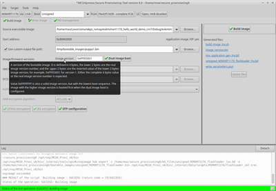

I'm dealing with the Image Index, which on Secure Provisioning Tool is called Image Version.
A popup appears on Secure Provisioning Tool that says:
A version of the bootable image. It is defined in 4 bytes, the lower 2 bytes are the real image version number, and the upper 2 bytes are the inverted value of the lower 2 bytes image version, for example, 0xFFFE0001 for version 1. Either the complete 4 bytes value or the real image version number is expected.
Value 0xFFFFFFFF is also a valid image version, but with the lowest boot sequence. The image with the higher image version is booted first when the dual image boot is configured.
I need you to explain the phrase: “Either the complete 4 bytes value or the real image version number is expected”. Does it mean that even just the lower part of the 32-bit word is enough, and it is not checked that it corresponds with the inverted upper part?
Also I tested two images, at offset 0 Image Version 0xFFFE0001, while the other image has Image Version 0xFFFD0002. The image started by the ROM bootloader is the second one (as expected). Then I replace the first image with one having Image Version 0xFFFFFFFF. I would expect the second to continue to be booted because it is written "Value 0xFFFFFFFF is also a valid image version, but with the lowest boot sequence. The image with the higher image version is booted first". But the ROM bootloader starts the first. Is there something I am missing?

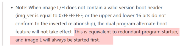

I think your test scenario where you had below dual image setup
Image Offset Image version
L 0x0 0xFFFFFFFF
H 0x00200000 0xFFFE0002
and your result was that image L was booted , instead image  H with the higher version, can be explained with the below note
This means that ROM bootloader used redundant boot, and not dual image boot.

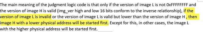

Test  Image L  Image H booted image Reason
1 0xFFFF_FFFF 0xFFFE_0001 L  L is booted first, considering this as redundant boot, not dual image boot. Working on a more clear description
2 0xFFFF_0000 0xFFFF_FFFF L Working on a more clear description
3 0xFFFF_0000 0x0000_0001 L H contains an invalid header
4 0x0000_0002 0xFFFE_0001 H L contains an invalid header
5 0xFFFF_0000 0xFFFF_0001 H H version number is higher
6 0xFFF_0002 0xFFFF_0002 L L version number is higher
*Where image L is at  0x30000000, image H is at  0x30400000
I took the note from our colleague Jay heng, article   https://www.cnblogs.com/henjay724/p/15942801.html but as I have been talking with him, my previous translation of his chinese article was not good, and I apologize for that. A more accurate translation would be more like this
However, let me get back to you with a clear and logic description of the above results, as well redundant and dual image boot. Currently we do not have more supporting information, I do apologize for the inconvenience. However,   I am requesting a ticket to the internal documentation team to update  RM information.
