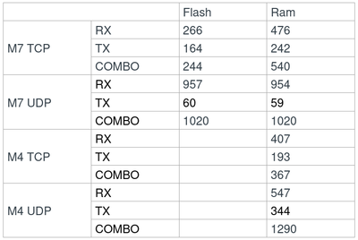

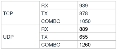

To test the PC NIC performance I tried iperf with another PC. So the performaces of my NIC when communicating with another PC are (performance is in Mbit/s):
To explain: on my PC I ran the server and on the client I used tradeoff (simultaneous bidirectional which I indicated COMBO) and dualtest (which runs RX and TX tests sequentially) modes. I verified that the dualtest mode achieves the same performance as the stand alone rx and tx modes.
On the board I ran m7 in flash and ram and the cm only in ram because the example I could not run in flash. Find all the examples attached (even the m4 flash one).
the results are as follows:
To explain: RX and TX TCP I calculated them using item 4 of the menu on the board, COMBO TCP item 3.
For similar UDP using items 9 and 8.
I'm not sure about the COMBO data, but about TX and RX I think they are reliable and the numbers I think are pretty much in line with what we should expect from a 1G eth. The only doubt is about UDP on M7 where TX is much lower than RX and much lower than TX on M4
There are the attached examples. Can you confirm that you get comparable numbers to mine?
Can you give an explanation why UDP in TX is slower on M7 than on M4? And why on M7 UDP TX is 13 times slower than RX?
Is this performance the maximum achievable by the combination of this peripheral + bus + core, or is the bottleneck the SW and so working on it could achieve more? And how much more? A few or many percentage points?

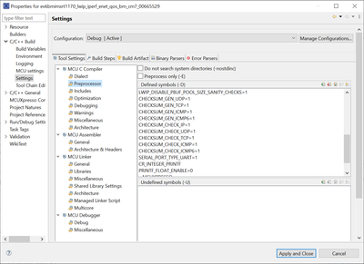

There seems to be something wrong with the Iperf UDP RX on your tests. This is why I mentioned the previous suggestion to disable the checksum.
This can be done under Project Properties > C/C++ Build > Settings > Tool Settings > Preprocessor:
BR,
Edwin.

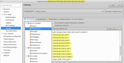

thank you for your response, but I must admit I’m rather baffled.
First, you suggested I modify the preprocessor settings, pointing to a potential checksum issue. However, as I’ve stated (and as you could easily verify by opening the projects I attached to my original message), the settings in my projects are identical to the ones in the SDK example. Indeed, it could not be otherwise since my projects are almost identical to the SDK project from which I derived them. Did you actually check the projects? Or are you basing your suggestion solely on assumptions?
Here a screenshot:

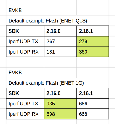

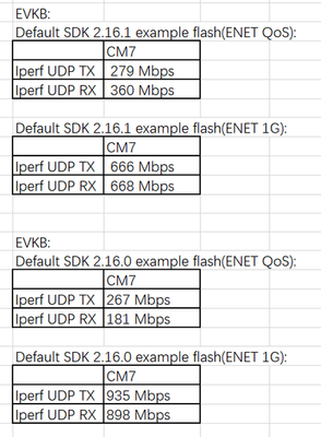

EdwinHz
Hi @mastupristi,
It seems like the issue might lie on the SDK's drivers. These are the performance tests done in both SDK v2.16.100 and 2.16.000:
As you can see, performance in the previous 2.16.0 is much higher and in line with the expected results. This is probably the issue you are seeing, and what is causing both bad performance on UDP TX, as well as CM7's underperformance compares to CM4.
I will investigate this issue further with the internal SDK team, but in the meantime, if you wish to execute without those issues, please use SDK v2.16.0 instead.
BR,
Edwin.

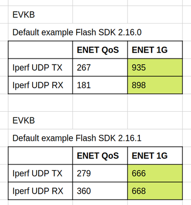

Hi @EdwinHz
just to see things from another point of view
this directly relates SDK 2.16.0 and 2.16.1
you say:
this is only true for ENET 1G.
How can you be sure of this statement?
What clues lead you to this conclusion?
Seeing the data I pick up conflicting clues: in my case (UDP over CM7 ENET QoS Flash opt -O3) RX 13 times faster than TX, in your case RX is 1.29 times faster than TX.
Also, you get much better performance with ENET 1G but I also get much better performance with QoS, whereas you have a very big difference between the two ENETs with other conditions being equal? Does this depend on the peripherals or the driver?
In conclusion, there are still several points that need to be clarified.
I find it hard to think of (only) problems with version 2.16.1
best regards
Max

EdwinHz
Hi @mastupristi,
The chart that I previously shared with you show that the appropriate performances for ENET 1G and ENET QoS on the default example code for both SDK 2.16.0 and 2.16.1, and they do not have a low TX like you showed on your initial chart.
This would have to be dependent on the peripherals, yes.
BR,
