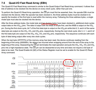

We have a custom board design with RT1170 MCU, our QSPI flash is from Renesas AT25SF321B  I wanted to ask;
1- How can I program QE (Quad Enable) bit for the first time. I have an MCU-Link. How should I start?

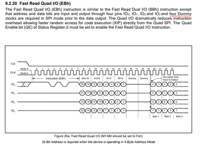

2- I've attached both Winbond Flash which EVK has and the flash that we used on our custom board Renesas, on the Winbond it states there are 2 dummy bytes but according to both diagrams, the configuration for the dummy clocks are the same. Am I missing something? What do you think?
3-  According to the DS from Renesas, which of the imported configs do I need to use? Because there are some conflicting parts for the example configs of the EVK flash. For example, .sflashA1Size is 16MB for the EVK, but the flash used on EVK is 64MB. And two config files have different commands, which one to use?

2 both diagrams, the configuration for the dummy clocks are the same. Am I missing something? What do you think?
Yes, 4 dummy clock equal to 2 dummy byte. In quad mode, 1 byte need 2 clock.
