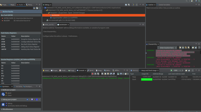

Hi, I just opened the EVK box and tested it.
I compiled one of the examples called `hello_world_demo_cm7` and it does not work. I also tried a couple of other examples, but it still does not work. the SDK version is 2.16
After finishing downloading the firmware, it gets stuck here.
I also tried to execute the same code on the Sram, it was working fine.
Is there anything I can do?

Hi @yudoc,
There are two EVK for RT1170, EVK and EVKB, each one has his respective SDK.
Could you check if the EVK you have match with the SDK you are using?
Please let me know your results
