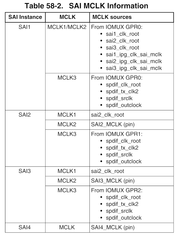

in the SAI chapter of the Ref Man rev3, you can find this table:
There are some perplexing points:
  1. It seems that SAI1 cannot be fed by MCLK pin as other SAIs, and it has sai*_ipg_clk_sai_mclk selectable
  2. SAI3 seems to be able to be powered only by sai2_clk_root, instead of sai3_clk_root.
  3. SAI4 seems to have enabled only one option (MCLK pin) and no sai4_clk_root option at all.

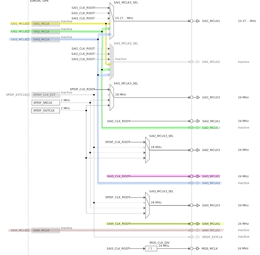

but on MCUXpresso Config Tools 24.12 I see:
Looking at this diagram I can rewrite the points above:
  1. sai*_ipg_clk_sai_mclk seems to be the same of SAI*_MCLK pin
  2. SAI3 seems to be able to be powered by SAI3_CLK_ROOT
  3. SAI4 seems to have 2 option enabled including SAI4_CLK_ROOT as well as SAI4_MCLK pin
I believe that the documentation has “problems” and needs revision. Anyway please share with me, because maybe it could be Config Tool that is buggy.

Hello
Thank you for your feedback, indeed the confusion is on the documentation side. Your 3 points are correct. From my side let me give these comments to the team responsible for the communication.
