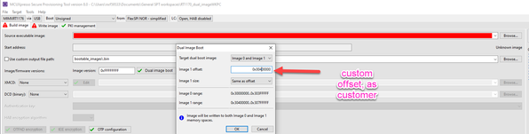

  1. Create a new SPT  workspace for the RT1170.
  2. Click on dual image boot button, select  Target Image 0 and Image 1 and place image offset of 0x0040_0000

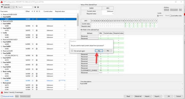

  1. The OTP config will turn red, as the tool detects that we need to burn 0xC80 fuse, to contain the given offset.
  1.  Set RT1170 to serial downloader mode and test connection, for example over USB.
  2. Open the OTP config and read current processor fuses.
  1. Find fuse 0xC80, the tool will show required value and current value. Click on Fix option, if needed, and click OK.
Then, you will see that the  OTP  config will turn green.
  1.  Provide image L as the source image and set a image version of 0x5. This an example version number. .
 Note:  With this setup the SPT will write the image version of 5 and the same image to both address space of imageL and imageH of  0x3000_2000 and 0x3040_0000 respectively

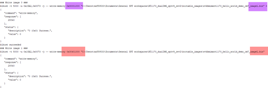

  1. Build and write the image.
This way image L  will be written to memory but twice, because image L will be written on the offset and space of image H. This is considered as redundant boot.

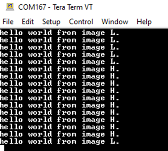

  1.  Set  MCU  to internal boot and check in the  console that image L boots, use serial terminal. diego_charles_7-1726089079834.png

  1. Check if image H boots.
  1. Keep doing tests, programing H and L with different valid version numbers. The image will the higher valid version should be booted.
The below image shows the ability to boot different applications.
