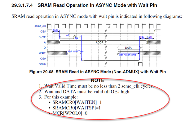

I'm designing an RT1170-based design that will interface with SRAM via the SEMC peripheral.
The SRAM is asynchronous thus I plan to use wait pin.
Are there any spec for wait assertion duration? I'd like to know the maximum wait time allowed.

No, RT1170 doesn't have such kind of timeout event, but the Wait Valid Time must be no less than 2 semc_clk cycles. Please check the data sheet of your SRAM device for more details.

Hi @Eugene3 ,
Actually the WAIT signal is a signal from the SRAM side, the duration is not controlled by RT1170 indeed.
Please kindly refer to the following for more details.

If SRAM device assert wait signal so long time, does RT1170 have a timeout?
