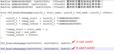

    Why the remap function of flexspi can not work when the HADDRSTART is 0x08000000 in M4 core,but it can work in 0x30000000.

The code runs on the m4 core, and the running rezults are shown in the screenshot. Why does 0x08008000 address not work when using flexspi remapping in the M4 core?

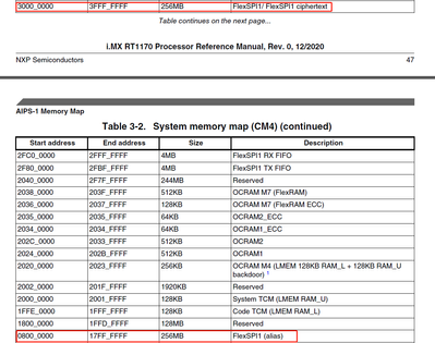

For both CM7 and CM4, the FlexSPI1/2 AHB map start address in Chip 4GB system map is 0x3000_0000/0x6000_0000.
0x0800_xxxx is not valid map address for FlexSPIx. it cannot be used for remap feature.
You can refer to below two blogs for FlexSPI remap feature:
https://www.cnblogs.com/henjay724/p/13538105.html
https://www.cnblogs.com/henjay724/p/13510275.html
2,424 次查看
13692631114
Howener, the chip data manual describes 0x0800_0000 as the mapped address of FlexSPI1. What's so special about FlexSPI1(alias)?
