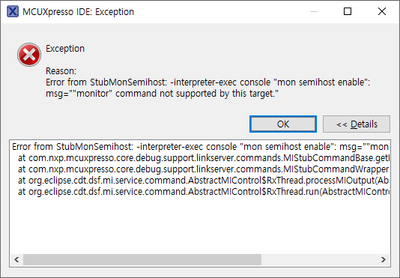

dskim2
Thanks for your reply
When I ran the source in MCUXpresso for debugging, the following error occurred.
How can I solve this?
Best Regards

Gavin_Jia
Hi @dskim2 ,
This demo is working and was able to build successfully on my end. But debug requires additional hardware. So you can adopt it as a reference implementation for an accelerometer driver. It should fit your needs.
Gavin
