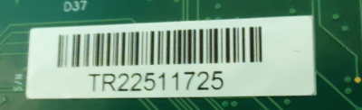

S/N of my EVKB is TR22511725
Processor marking is:
I give you this info on the off chance that it really is a batch of faulty processors. This component should be of the 23rd week of 2022
However, we have experienced this problem on other processors, certainly from other batches
this should be of the 27th week of 2021
