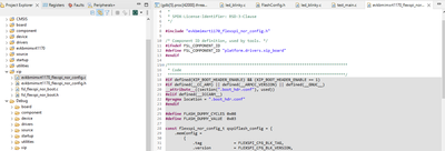

diego_charles
Hi @sandeepc and @johannzimmerman
Please replace the contents of the evkbmimxrt1170_flexspi_nor_config.c file with the contents of the attached file below and let me know your results.
Or, from the current evkbmimxrt1170_flexspi_nor_config.c from the SDK 2.15 replace
#define FLASH_DUMMY_CYCLES 0x08
#define FLASH_DUMMY_VALUE  0x03
With
#define FLASH_DUMMY_CYCLES 0x06
#define FLASH_DUMMY_VALUE  0x00
Diego

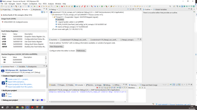

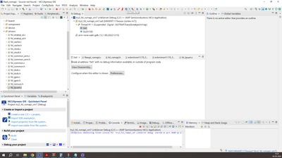

In debug mode ROM_FLEXSPI_NorFlash_GetConfig when this function is called got below fault:
Break address to 0x35052 with no debug information available or outside of program code.

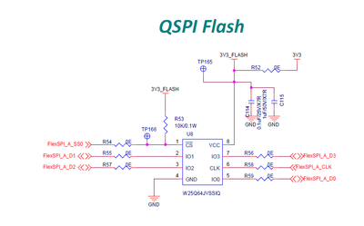

Schematic:
I tried all the ways as you mentioned please look in to my shared files.
Can you share the working code.
Sandeep c

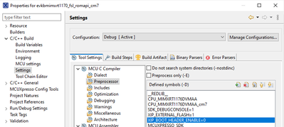

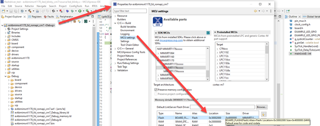

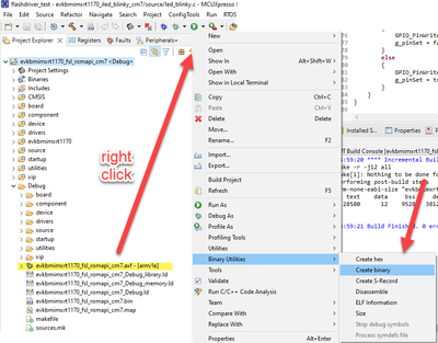

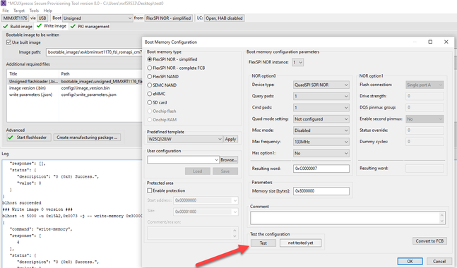

I see that you are using a similar NOR flash memory to the one in the EVK ( W25Q512NWEIQ). You need a bit different flash memory configuration to make the Boot ROM API work. So, I think your problem can be solved with another configuration to your flash memory. With the below steps I show you how to use a generic config using the MCUXpresso secure provisioning tool.
See my steps below.
1 Provide the flash an offset of 0x3000_2000.
2. Disable XIP header.
This means that the QSPI flash config structure of your project will not longer added to the image
3 build the image and create a binary.
4 Download and install the MCUXpresso Secure Provisioning Tool.
5 Create a new workspace for the RT1170.
6 Connect your RT1170 to the SPT tool. You will need to be able to set the MCU to boot from serial downloader mode and use the UART1 or USB1 ports.
7 Test  and adjust your memory configuration.
If the test fails you may need to do any adjust to your memory configuration. Let me know if required to change any paramater to make test be succesfull.
8. Provide your image to the SPT and build it.
9.Write the image

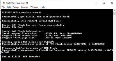

10. Set the RT1170 to boot again to 'internal boot ' mode. Connect a serial terminal emulator.
I was able to make the SDK 2.15 ROM API demo this way. The SPT generated a basic flash memory config that allowed the boot ROM APIs to write the application. I tested this with the W25Q512NWEIQ flash from the EVK.
I hope this could help you!

I tried as you suggested to follow step by step still its not working.
here i will share my modified example code can you check with your evk board, so that i can ask our hardware team to review our schematic.
here i attached complete description document, as well as two zip files.
1) Description with detailed iamges
2)1st try zip file description:
just imported the example and i modified according to your steps
3) 2nd try zip file
i modified core clock to 800MHz
       a)Option 0 clock to : 100 Mhz
       b)Option 0 clock to : 30 Mhz
Note: As per this link
RT1176 - flexSPI DQS connection for max R/W speed - NXP Community
Solved: SEMC_DQS and FLEXSPI_DQS signal in iMXRT117x - NXP Community
we have not left E14 pin as floating, E14 pin in our application used for one of the peripheral interrupt pin, so we cant left as floating.
so we changed in xip file
flexspi_nor_config_t :
from
.readSampleClksrc=kFlexSPIReadSampleClk_LoopbackFromDqsPad,
.serialClkFreq = kFlexSpiSerialClk_133MHz,
to
.readSampleClksrc=kFlexSPIReadSampleClk_LoopbackInternally ,
.serialClkFreq = kFlexSpiSerialClk_100MHz
but if disable According step2:Disable XIP header.
readSampleClkSrc will be what? if i want change how can i change?
Sandeep C
