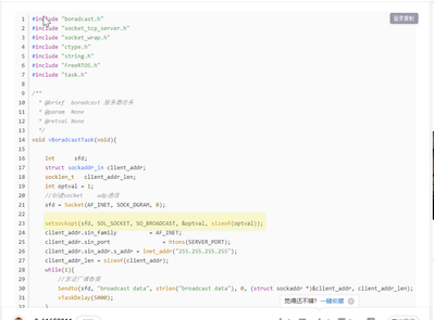

kerryzhou
Hi @akift ,
  My example is the multicast, not the broadcast.
 To the broadcast, do you try this code:
You can try it again.
Wish it helps you!
