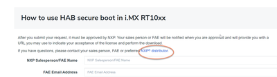

Your second link to AN12681 I can't download it, it asks me for a provider name and email, I put Mouser's, but it's not accepted.
How can I download AN12681? My usual supplier is Mouser.

   AN12681 Application note needs the special approve, you can see the note when you download it:
Just input the distributor is not enough, it need the NXP salesperson or the FAE approve, so you need to contact with your distributor at first, they will help you contact with the NXP related person, I also don't have the approve authority.

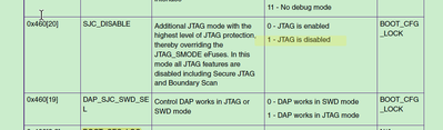

A question about preventing access to modify or read the flash. You tell me that following your instructions the access by SWD would be denied, but the access by JTAG would be active.
So the question is whether it is possible to prevent all types of access, both by JTAG and by SWD. Leave the chip in a state that after loading my firmware, no one can access the chip either by JTAG or SWD, so it could not be read, modified or deleted.

   Yes, you even can disable the debugger interface:
 Then, the external side can't access the flash through the JTAG/SWD interface.
  But, if your boot mode still can be set, then RT1064 still can be access from the serial download mode, so, you also can change the boot mode to the fuse boot mode. More details, check the RT1064 RM, chapter 9.3.3 Boot From Fuses mode (BOOT_MODE[1:0] = 00b).
