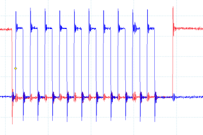

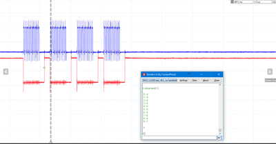

I currently have a project that communicates with a FPGA, and I have been successful using the AHB to get and set registers on that FPGA. The issues occur when I am in a for-loop requesting data consecutively. I can see on the scope, the Flexspi control line is not always being toggled and the read returns with the same data that it had on the last read cycle (on failure). It seems like some times it gets 3 reads in a row successfully and then it would skip 1 and only issue a read on the following attempt.

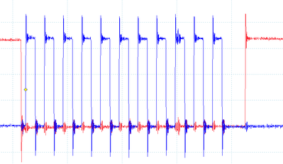

I have been able to add "NOP" wait states to my for-loop to delay the next data request and it seems to remedy the situation. I just dont have an answer to why that is the case.

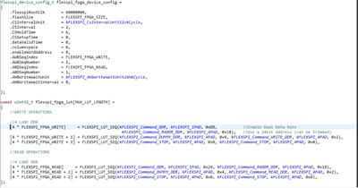

Here is a brief overview of my configuration for the data transfer:
Using DDR, Caching is Disabled, Prefetch is Disabled, Clearing is turned On after read.
Here is a look at what my transmission looked like:
Transmissions without NOP wait states:
Transmissions with NOP wait states added:

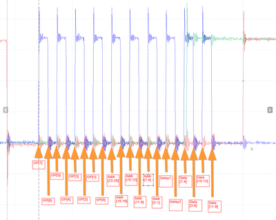

Okay I believe I have a understanding of what is occurring.

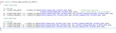

My FPGA State machine is setup and based on 11 SClk cycles.
My Lut Table is also configured for this.
If i use the "FLEXSPI_TransferBlocking()" function to perform the read, it issues 11 SClk cycles, and I get the correct data.
If i use the AHB method, I only get 10 SClk cycles.

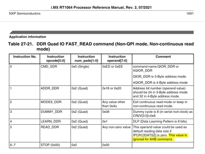

A colleague pointed out in the Reference manual. The READ_DDR instruction in the Lut table is ignored for AHB mode.
I guess a follow-up question to my original question is, how are data bytes supposed to be retrieved from an external device when using AHB? There is not enough SClk cycles to do any more than a byte at a time. which, we currently are using a 2 Byte Data transfer. Which explains my failure.

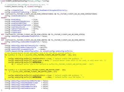

What is the size of your AHB read buffer? With the NOP are you consistenly reading all the requested data?

There were two different things I was dealing with...
  1. Missing SClks
    I had expected to always get 11 SClks and I could not figure out why.
    My AHB buffer sizes are the default settings in the fsl_flexspi.c driver:
    Buffer0 = 0.
    Buffer1 = 0.
    Buffer2 = 256.
    Buffer3 = 256.
    I eventually discovered that I could get different sclk counts by reading/writing different byte counts.
    So if I read:
    unsigned char = 10 SClks.
    Unsigned short int = 11 SClks.
    unsigned int = 12 SClks.
    I am not sure what underlying mechanism is controlling the AHB Data Byte Count to SClk Generation Relationship. I suppose now that I know of this, this issues is less critical. But would have been helpful to read in the reference manual.

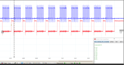

  2. AHB Data Caching
    I discovered that if I poll for the same address multiple times in a row, the data was not always the most up to date value. I setup a simple test in my FPGA to prove this. Every time the address is read, I increment a counter that I read out when the address is targeted.
    So, if I read an address 10 times in a loop:
    I expected 1, 2, 3, 4, 5, 6, 7, 8, 9, 10.
    I actually got 1, 2, 2, 3, 3, 4, 4, 5, 5, 6.
    On the Scope:
    I observed that instead of 10 FlexSPI Data transmissions, I only seen ~6. So the AHB/Flex SPI is not issuing the request.

Thank you very much for your patience, I have been consulting this internally, please find below our feedback.
For your case, it is better to use FlexSPI IPG cmd to communicate with FPGA for register settings.
For "The READ_DDR instruction in the Lut table is ignored for AHB mode", the understanding is not correct, just the operand value of READ_DDR sequence will be ignored, as the burst data length is determined by AHB master.
For "how are data bytes supposed to be retrieved from an external device when using AHB?" This is determined by AHB burst mechanism.  Our colleague Jay Heng, created the below articles can can help.
