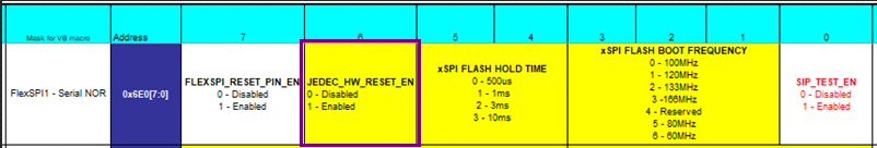

@Masmiseim is right, after setting the 0x6e0[6] bit, the ROM boot can execute the JEDEC standard reset (as below shows). So I'd like to suggest you take the @Masmiseim 's advice if your board is suitable.
TIC

where can I find the documentation about the 0x6e0[6] fuse?
Sven
16,560件の閲覧回数
jeremyzhou
1) Where can I find the documentation about the 0x6e0[6] fuse?
-- Please check the following figure.
TIC
