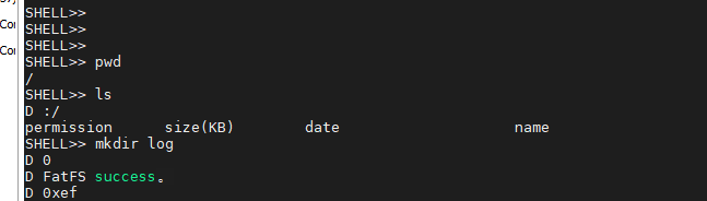

Hello
Because we don't use sd card on our board, so the file system can only be ported on nor flash. There is rom api in the official sdk package, so I ported the file system based on this. However, during testing, it was found that sometimes it could be mounted, and sometimes it could not be mounted. When I use to create directories and files, there is a high probability of failure or even board reset.

The device resets after entering the create directory command.

jeremyzhou
I'd like to know the ratio of the issues happening, further, whether you can introduce the steps of porting code and upload the whole demo code.

2548903578
I modified the romapi demo based on the development board to create a fatfs project on nor flash. The phenomenon is exactly the same as when I first started. Hope you can give me some advice! thank you very much!
3,903 Views
jeremyzhou
Thanks for your reply.
Firstly, according to your reply, it will encounter the issue after the task scheduler begins to work, is it right?
Second, I was wondering if you can list the steps of porting code,
Lastly, I guess the issue may be related to a lack of taking critical section protection prior to calling ROM APIs, I‘d like to suggest you use the pair of taskENTER_CRITICAL() and taskEXIT_CRITICAL() to do it.

2548903578
After several days of testing, it was found that the program was running in the flash and used the file system to operate the flash. This will cause the program to hang. Now you can run the program in the external sram. But another problem is that I am using the mcupresso Secure Provisioning tool to program the program, which will cause me to adjust the mode of the board every time. It is not possible to download directly using the ide. And it is also very inconvenient for debugging. I would like to ask if the program can run directly in the external SRAM? It doesn't matter if the power is lost. This makes debugging easier.
