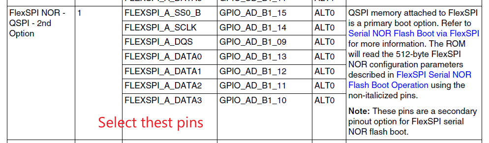

We have a design which connects one NOR Flash with FlexSPI 2nd Option. I means choose the pins of 'FlexSPI NOR - QSPI - 2nd Option' of 'Table 9-1. ROM Bootloader Peripheral PinMux' in reference manual.

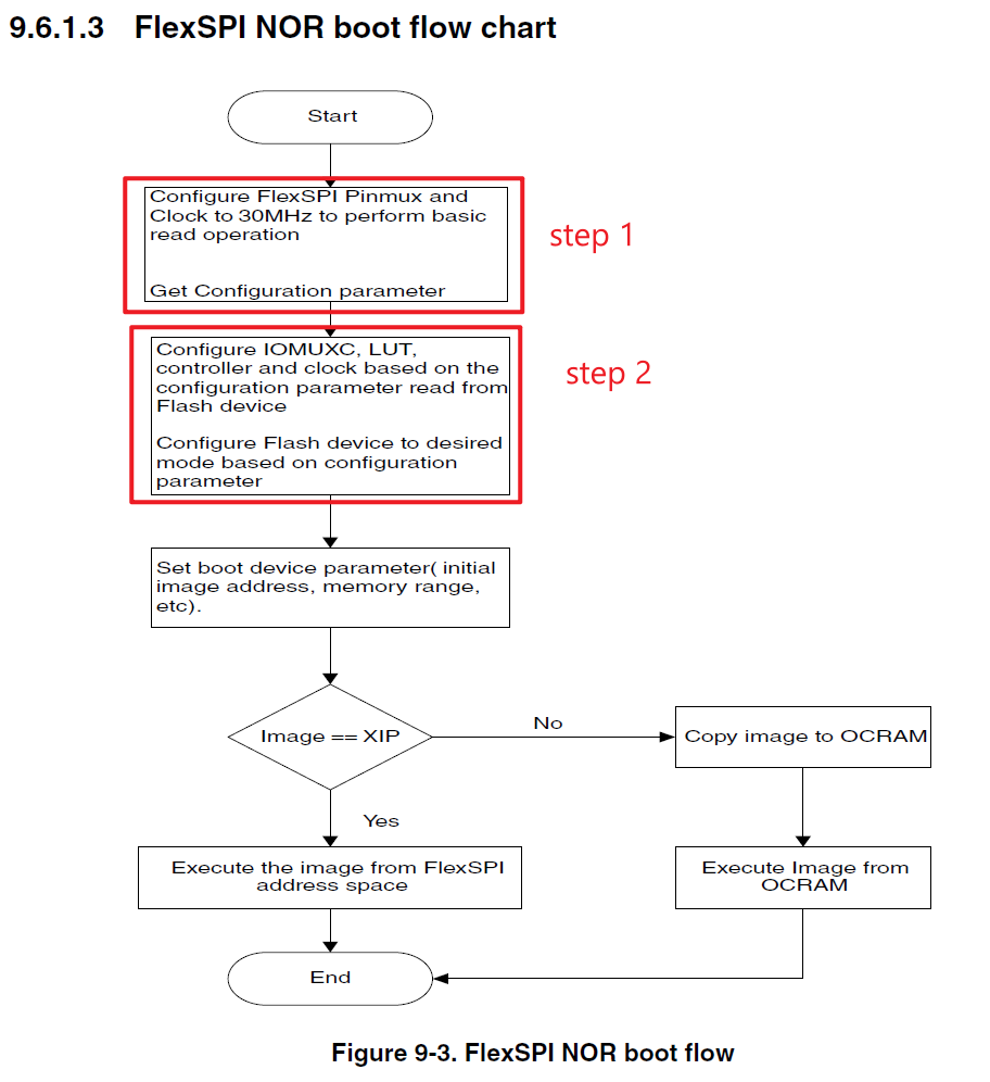

When I read the chapter of '9.6.1.3 FlexSPI NOR boot flow chart', it looks like there are two steps about FlexSPI pinmux configurations in BootROM.
  1. Configure FlexSPI Pinmux and Clock to 30MHz to perform basic read operation to get Configuration parameter
  2. Configure IOMUXC, LUT, controller and clock based on the configuration parameter read from Flash device to get bootable image
So, I think need to make BootROM selects FlexSPI QSPI - 2nd Option in step 1, and make configuration parameter have the correct IOMUXC in step 2. But I have two questions about two steps.
  1. How BootROM select FlexSPI Pinmux in step 1?

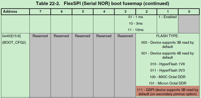

Yes, this is configured through the Fusempa, please see the below image.

The IOMUXC registers mentioned in step 2 are configured by the ROM bootloader. Table 9-1 of the reference manual shows all the pins that are configured by the ROM bootloader.

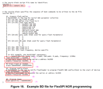

Thanks for answer of Step 1. But for Step 2, Use of "FlexSPI NOR - QSPI - 2nd Option" in Table mentions the ROM will read 512-byte FlexSPI NOR configuration parameters. In Table 9-14, Table 9-15 and Table 9-17, no configuration is related to PINMUX. Does this mean BOOT_CFG2[2:0] has selected the correct group of PINMUX when boot?

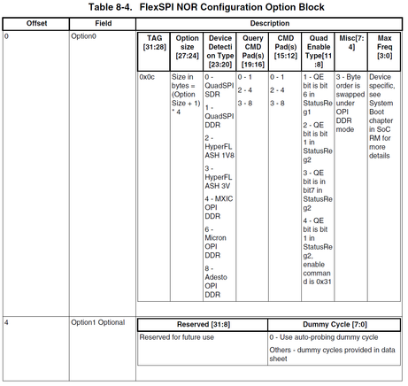

If so, I have another question about SB file which is mentioned in i.MX MCU Manufacturing User's Guide.pdf. Figure 18 has an example of FlexSPI NOR programming. I think (2) (3) is to tell Flashloader how to configure FlexSPI for programming. (5) (6) is to tell Flashloader how to program 512-byte FlexSPI NOR configuration parameters (I suppose SB file with generate and program this 512-byte section). How to tell Flashloader select the correct PINMUX for programming? Looks like the bits of Flash option in (2) doesn't have. Any other options? Table 8-4 in MCUX Flashloader Reference Manual.pdf only has details of option0.
I got i.MX MCU Manufacturing User's Guide.pdf and MCUX Flashloader Reference Manual.pdf from package of Flashloader i.MX-RT1050 in the home page of i.MX RT1050.

In step 1 of the flow chart that you shared before, the ROM bootloader will check the values of the fuses as well as the boot mode configuration and it initializes the corresponding pins to communicate with the memory. It's the bootloader that selects the corresponding pins.

I have connected one external NOR flash to my EVKB. And make bd file as below to build SB file. Programming and boot are working.
My another change is for Flashloader which source code from SDK. My prototype fails with 0xEBh(fast read quad). It could fail at 0x1700, 0x1F00 or 0x2000. And logic analyzer got the wrong data as RT1050. Maybe it's caused by my long wires. So I replaced with 0x03h(normal read), which works finally.
However, I think my prototype has proved it works.
Jerry

load fuse 0x00000700 > 0x05; #FLASH TYPE: 111 - QSPI device supports 3B read by default (on secondary pinmux option)
load fuse 0x00000010 > 0x06; #BT_FUSE_SEL=1
