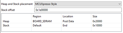

kwolley
Hi @mark82 ,
I have not found a reasonable explanation for this.  My current workaround is to change the stack offset and use half the memory space (not ideal).   For example in Properties -> C/C++ Build -> Settings -> MCU C++ Linker -> Managed Linger Script :
I hope this helps.  Let me know if you solve the issue.
