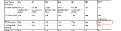

We aim to wake up the device automatically using SRTC alarm, but it's not working.
We test both RTC and SRTC alarm in full speed mode, and SNVS_HP_WRAPPER_IRQHandler() was triggered by RTC source kSNVS_RTC_AlarmInterruptFlag. However, it appears that no activity or response was triggered by the SRTC alarm.
Then we set SRTC alarm and attempted to enter SNVS mode with following code:
SNVS->LPCR |= SNVS_LPCR_TOP(1);
But the device can not wake up. We read the counter register like the demo snvs_lp_srtc in sdk, the srtc timer still working.

We modified the code based on the power_mode_switch demo, and the SRTC was able to wake up the core, but it's unstable.
We have disabled the long-press function by the following code:
SNVS->LPCR &= ~SNVS_LPCR_BTN_PRESS_TIME_MASK;
SNVS->LPCR |= SNVS_LPCR_BTN_PRESS_TIME(3);
SNVS->LPCR &= ~SNVS_LPCR_DEBOUNCE_MASK;
SNVS->LPCR |= SNVS_LPCR_DEBOUNCE(2);
and we do not invoke this code under normal conditions:
so, it seems that the device will not enter the SNVS mode, but somehow, it's still hanppened. Is there any other way to enter the SNVS mode, like power supply fluctuation? Or is it possible that a reset event occurred, but DCDC failed to work out, and device looks like enter the SNVS mode?
