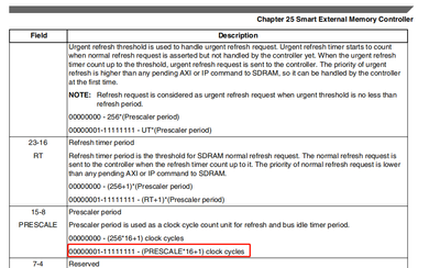

RT1052 SDK2.11.1 fsl_semc.c SEMC_ConfigureSDRAM() calculate prescale is not correct
974 Views
dasg
fsl_semc.c SEMC_ConfigureSDRAM(), SDRAMCR3, prescale shoule calculate as follow picture. Please fix this issue
968 Views
jeremyzhou
Okay and thanks for your advice.
