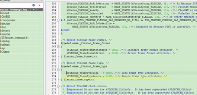

My project contains CAN communication with remote frames ,but it is no available sample code in SDK. Would you please provide me a  sample code with remote frames?

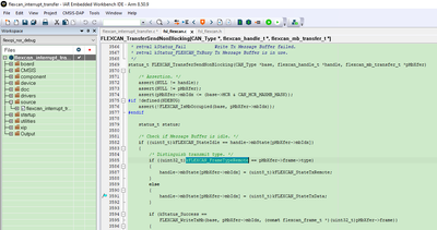

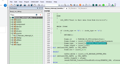

   In fact, our RT1050 SDK flexcan driver already contains the remote control, so you can try to modify the flexcan project, change the frame trype from the normal data to remote.
Please try to modify the code and test it on your side.
