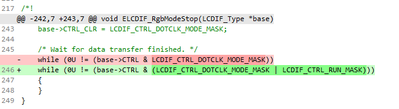

ecorini
I have a similar problem (crash) when calling ELCDIF_RgbModeStop + ELCDIF_Deinit.
Problem disappeared when using "fsl_elcdif" driver from SDK 2.16.0
It seem that this change in NXP SDK corrected the problem:
Best Regards
