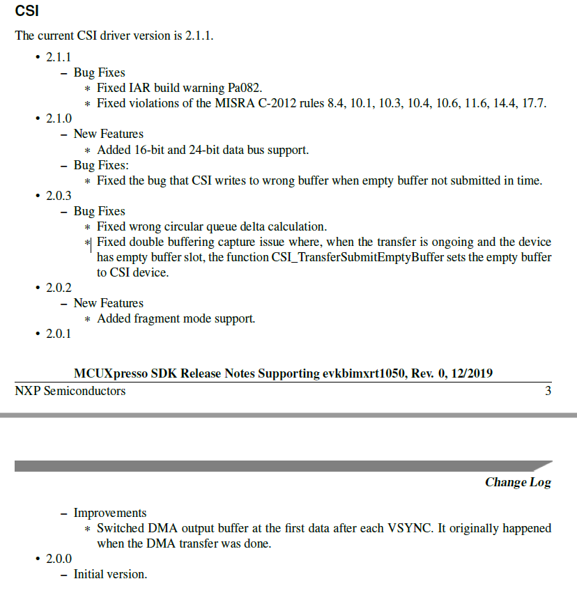

jeremyzhou
Hi ,
Thanks for your reply.
1) Can you confirm this is an issue or how code needs to be changed to work with the latest version of the CSI drivers?
-- Firstly, I don't see an issue report about the latest_csi driver, so I basically don't believe there're something bugs in the latest_csi driver, The Fig1 log the evolution of CSI driver and it can help you to adjust the code. Now it’s time to get our hands dirty with the code.
Fig 1

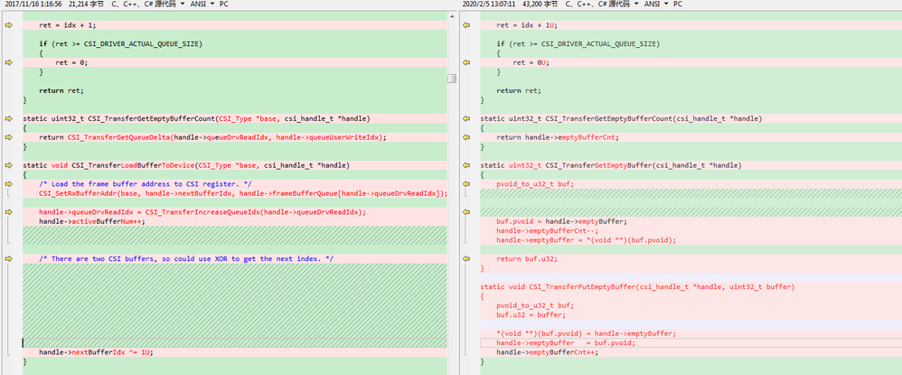

jeremyzhou
Hi ,
After comparing the fsl_csi driver of version 2.0.0 and 2.1.1, I find that the difference is a bit big(as below shows).
So I'll suggest you continue the version 2.0.0 at currently, as it's dirty work to adjust the fsl_csi driver of the version 2.1.1 to replace the version 2.0.0.

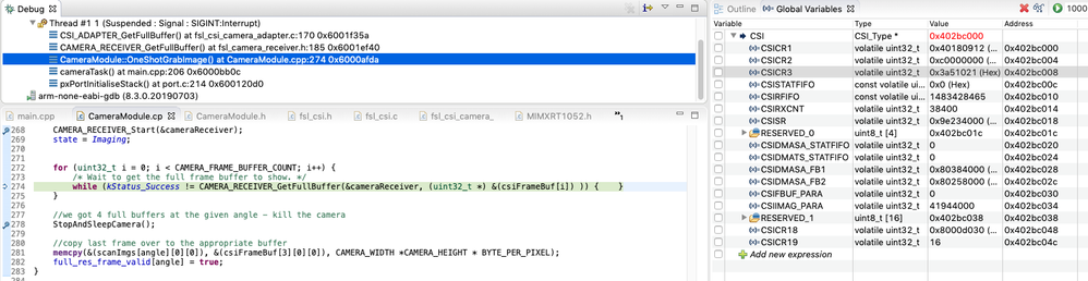

One further follow-up, if I set a breakpoint on the check for GetFullBuffer, and monitor the CSI, I'm seeing that
CSICR3 frame count is increasing - so I don't understand why I wouldn't be getting FrameBufferFull from the SDK?
I can confirm that CSICR1 has interrupt enable for both CSI FB1 and FB2.
Here is what the registers look like:

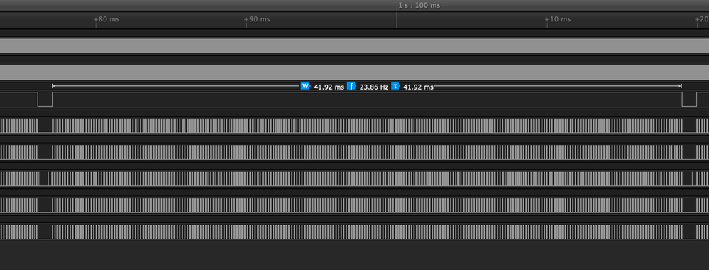

and another note is - unlike some cameras that do a pulse for the start of VSYNC and a pulse for the end, the AR0130 we're using keeps VSYNC (frame valid) asserted for the full frame, like the 3rd line below (1st line is CSI_MCLK, 2nd is PXCLK, 3rd is VSYNC, 4th is HSYNC, then data):
