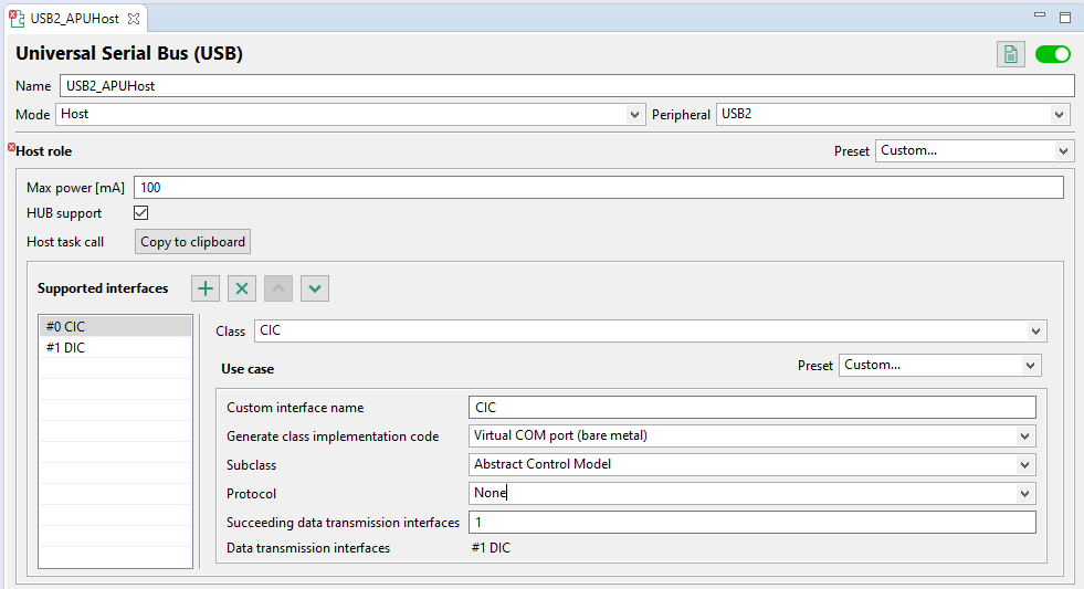

I'm using the MCU Config Tools to create the USB Host peripheral in the project.  Here's the CIC setup:
The DIC is also the default setup.  I did have to manually edit usb_host_app.h to change the EHCI instance from 0 to 1; I have a separate thread on that here.  (I'm currently using SDK 2.7.0. and MCUX 11.1.0.)  For what it's worth, I have all caching disabled, because of earlier difficulties encountered while developing Ethernet and SD/MMC code.
