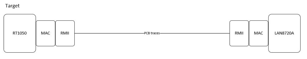

Hi experts,
We are working on a project using Azure RTOS and have come up with a new approach.

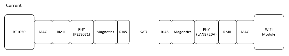

We are currently using a physical connection between PCBs via ethernet between RT1050 and a WiFi module (xPico XPC240300S-02).

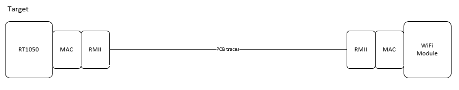

I have been looking at the possibility of removing the PHY layer completely and connecting these two devices using the RMII connection of both.
From what I've read in the forum, people seem to have achieved satisfactory results, although it's not exactly the same case.
Is it possible to make this connection between the RT1050 and the WiFi module using only the RMII connection without transceivers or magnetic?Would it be possible to use the Azure Net Duo API with these modifications?
In theory and connections it seems very simple, in practice it seems something complex or without viability.

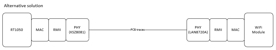

Another option would be to keep the PHY layer but without wires, using traces and controlled impedance to integrate this on a single PCB.
What do you think? can anyone contribute some information? it seems that with a little work it could be done, at least, some of you have done similar things.
Any comments are welcome
Thank you in advance

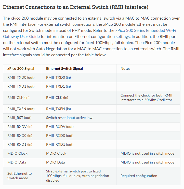

STDMED
Hi jeremyzhou,
According to Lantronix documentation, this module has an ENET interface, we have performed tests using ENET interface with PHY, Magnets and xPico in Bridge mode, everything works correctly. That is why we started this topic.
In the official documentation you can see the ENET connection interface on the xPico.
I attach a screenshot:
https://docs.lantronix.com/products/xpico-200/ig/functionaldescr/#ethernet-connections-to-an-externa...
Maybe I'm missing something?
Thanks !!!

STDMED
Hi jeremyzhou,
I have attached the module design documentation in the previous post, the link you attach is not the datasheet, it is only a summary of features.
Please check the link above where you will find the complete documentation and partial designs.
This is the datasheet of the module:
http://www.lantronix.com/wp-content/uploads/pdf/Lantronix-xPico-200-Data-Sheet.pdf

jeremyzhou
Thanks for your reply.
After having a brief review of the above datasheet, I think the below connection is available.
However, to be prudent, you'd better contact Lantronix to confirm.
TIC
9,393 Views
jeremyzhou
Firstly, the below connection is definitely available.
Moreover, in the SDK library, there's the driver for the PHY chip: KSZ8081RNB, and you can refer to the attachment to modify the driver to fit the LAN8720.

Hi jeremyzhou, thanks for replying, I think it was not quite clear the idea, sorry for my mistake, I have edited the initial post and attached new images to clarify which is the connection.
