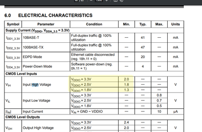

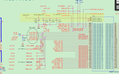

Hi @kerryzhou ,
My customer board ENET_INT pin use the same schematic as EVK, solder both the pull-up (R309, 1K) and pull-down (R152, 1K) resistors. The ENET_INT output is 1.65V to PHY, can it disable the PHY NAND tree mode successfully? If not, any problem will happen?
1,636 Views
kerryzhou
Hi @felix1 ,
   In fact, you just need to check your used PHY, whether 1.65V can be indicate as the high level, if yes, then it is OK.
 So, please check your used PHY datasheet about the high level situation.
Kerry
1,632 Views
felix1
Hi @kerryzhou,
I copy EVK's network schematic, the PHY KSZ8081RNB is the same as EVK, so I need to know the design of EVK's ethernet is stable or not?
1,629 Views
kerryzhou
Hi @felix1 ,
  Please check the PHY datasheet:
https://ww1.microchip.com/downloads/en/DeviceDoc/00002202C.pdf
page 46:
You can find, if your VDDIO is 3.3V, the input High voltage min is 2.0 V, so your 1.65V is not enough.
You may need a voltage switch to change the voltage level.
Why you don't refer to the EVK board, the NVCC_GPIO is using the 3V3?
If you do it like this, I think you can output 3.3V as the high level.
Wish it helps you!
Kerry
