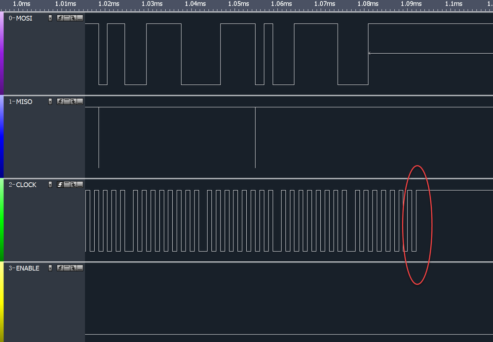

TL;DR - On the RT1050 LPSPI peripheral, when continuous mode is active (TCR.CONT == 1), the last SCK edge of a transfer does not complete, which means the last byte does not arrive in the RX FIFO, which means that when implementing a SPI driver API, nothing can continue after a read transfer, because the read request cannot be closed out without sending at least one more byte into the FIFO, and clearing CONT would de-assert PCSx and terminate the transfer.
So, I've been writing my own C++ LPSPI driver, using the FSL driver and other code as examples.  The base class for my SPI driver consists of two methods:

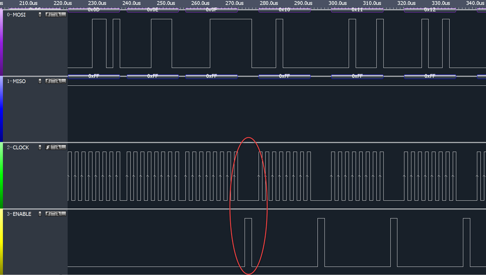

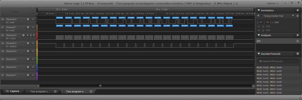

However, THIS IS NOT POSSIBLE with the NXP LPSPI peripheral, based on my own testing and one other forum post on this exact topic involving a Kinetis KL28 LPSPI.  Here's a screencap of a 20-byte transfer, with CONT == 0:
CONT == 0 obviously won't work for a SPI device access, with PCSx de-asserting between every byte.  But here's the same transfer with CONT == 1 (the only change made in the code):

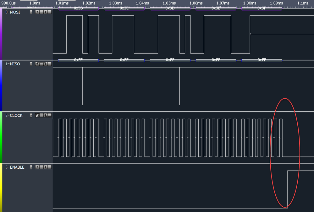

You can see that the last half-clock doesn't appear on SCK; the clock stays high, and PCSx stays asserted because I haven't written to TCR yet.  This results in the last (zero) byte not arriving in the RX FIFO, which causes my driver to stall because the expected 20 bytes are never fully received.  If I write TCR with both CONT and CONTC set to 1, this doesn't change (I tried it, SCK remains stuck in the middle of the final bit).  And if I write TCR with CONTC set to 0, then yes, the lask SCK edge appears and the last byte arrives in the RX FIFO, but this also de-asserts PCSx and terminates the transfer.
I consider this to be a bug/erratum in the LPSPI peripheral, because it unnecessarily constrains the behavior of the software using it.  My SPI driver cannot perform another transfer following a read while keeping PCSx asserted; performing a read requires that it be the last transfer before de-asserting PCSx.  I've worked around this in my driver by doing two things:

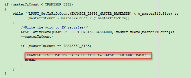

I did a test with MCUXpresso SDK V2.5.1 lpspi driver demo [\interrupt_b2b\master] with IMXRT1050-EVKB board.
When I set Transmit Command Register (TCR) [CONT] bit to enable continuous transfer, I could regenerate your mentioned issue:
Then I add clear Transmit Command Register (TCR) [CONT] bit code at IRQHandler function, which could fix the issue:
From RT1050 reference manual, the LPSPI command word in master mode [CONT] bit can be modified during transfer.
If clear LPSPI Transmit Command Register (TCR) [CONT] bit during LPSPI communication processing, Then the chip select will exit continuous mode during transfer.
So far, customer can clear LPSPI Transmit Command Register (TCR) [CONT] bit after required bytes had been transmitted.

The first call to lpspi.Read() can't complete because the last byte will not enter the RX FIFO without 1) writing the next dummy byte to the TX FIFO or 2) writing TCR with CONT or CONTC set to 0, which also terminates the transfer.  The driver's hands are completely tied; writing an extra dummy byte is out of the question (there's no way to know what's supposed to come next), and terminating the transfer is also not an option.  My only workaround is to restrict the driver and generate an error if lpspi.Read() is called with "terminate transfer" set to false.
This really looks like a defect in the LPSPI peripheral; there's no good reason for SCK to freeze in the active state on the last bit of a transfer and withhold the last byte from the RX FIFO until either the next byte is written or the transfer is terminated.  I do now have a working C++ driver for LPSPI, with the aforementioned restriction that any read operation must also terminate the transfer, which is probably fine for most SPI device drivers.  It's just frustrating that NXP hasn't noticed or addressed this before now.  As I mentioned, someone had this exact same issue two years ago with a KL28 LPSPI, and you gave the same advice, which was to write TCR with CONT and CONTC clear to terminate the transfer and get the last byte into the RX FIFO.  But if you don't want to terminate the transfer at that point, you have no other option.
