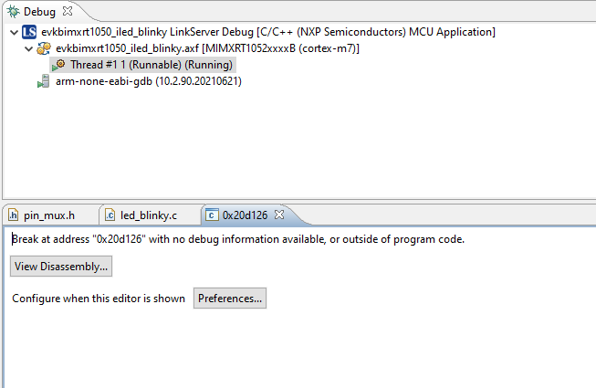

Andy_h
this is the result of the change of SW7. The process stops at this point. Is there a way to fix this?
best regards,
andy
3,293 Views
jeremyzhou
Thanks for your reply.
It seems a bit weird, maybe you can try to update the firmware of the onboard debugger.
TIC
