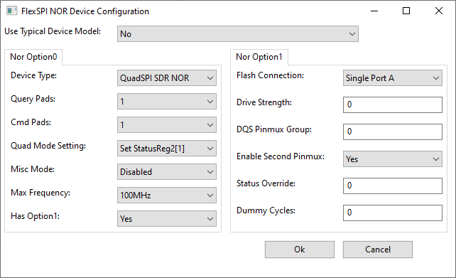

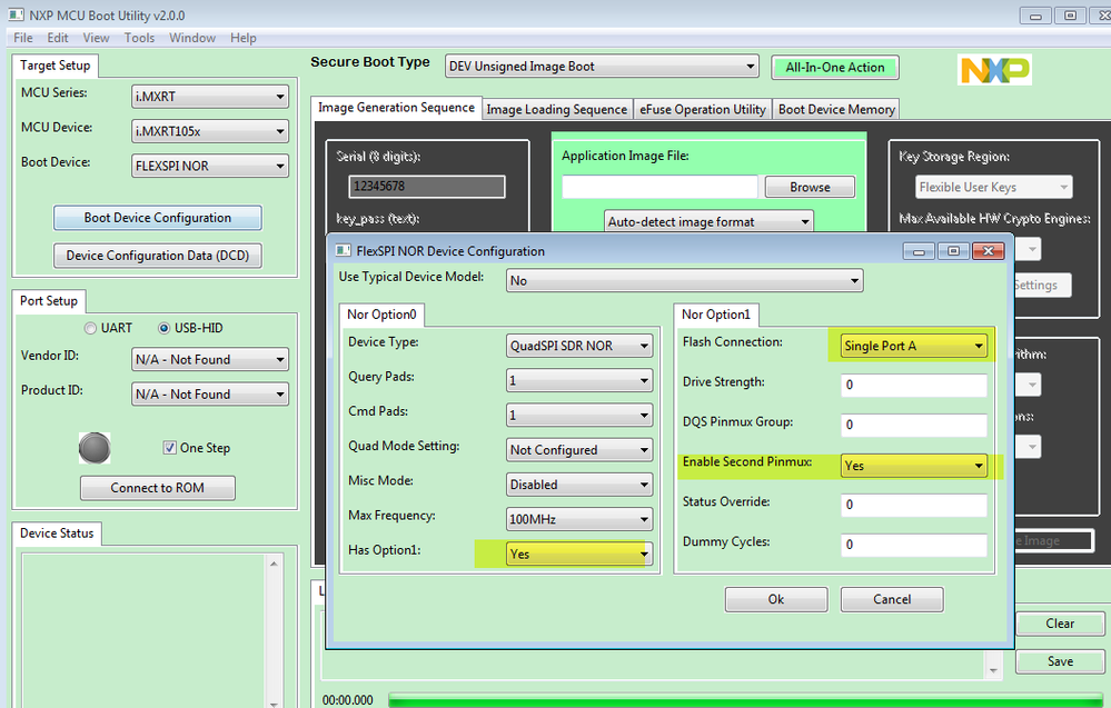

We also replicated the configuration DIP switches that are present on the EVKB.  Referring to Table 8-9 of the RT1050 manual, I could see that BOOT_CFG2[2:0] (i.e. BOOT_CFG[10:8]) needed to be "111" for "QSPI device supports 3B read by default (on secondary pinmux option)", not "010" for "HyperFlash 1.8V".  So I set the DIP switches to "0000 0011 0110" to select Flash Type 111 and Boot Type 10 (internal boot).  And it appears that I've set the DIP switches correctly, because if I reset the processor, I see this on the QSPI pins:

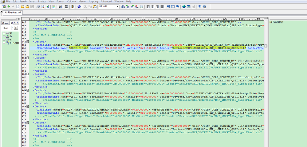

The debug pod (SEGGER J-Link Pro) connects OK with the CPU; there was some initial confusion over what debug mode to use, but we now have SWD selected.  When I try to program and download an image, the SEGGER four-bar programming window appears, it gets to 25% compare a touch slowly, then 50%, then the window disappears:

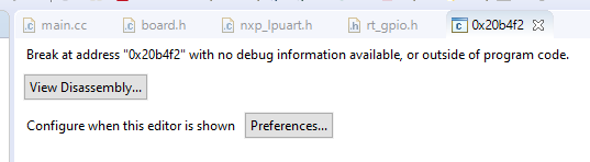

Then the debugger lands at address 0x20b4f2 (the actual address for any given run is somewhat random, I got 0x20d136 another time):
And you pretty much can't do anything at this point.  The addresses clearly reside inside the ROM region, so presumably the RT1050 was not able to boot successfully and remained in its ROM program.

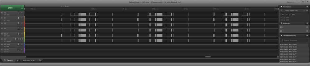

Here's what I see on my Logic probe while launching the debug session:
That big burst in the middle there is a whole bunch of transfers, each lasting about 259 us and spaced apart every 6-7 ms.  So, any ideas what we're doing wrong?  I certainly can't rule out a hardware issue, but it looks like the signals between the CPU and the QSPI flash are OK.  Maybe one has to do some additional configuration of the J-Link debug launch.  Where should I start?

I've provided several screenshots above, showing QSPI bus activity, the behavior of the SEGGER programming window, the debugger context when the debug session launches, and the error dialog when I try programming the board directly using MCU Boot Utility.
I'll provide a summary of my configuration and my issues here:
  1. We have a custom RT1052 board with a QSPI flash attached to the secondary pinmux location, as specified above.  The flash was not pre-programmed prior to board assembly; it should be completely blank.
  2. The board has a full complement of DIP switches matching the EVKB, allowing configuration of all relevant BOOT_CFG and BOOT_MODE settings.
  3. We appear to have the correct BOOT_CFG/BOOT_MODE selection (internal boot, QSPI on secondary pinmux) because the RT1052 accesses the QSPI flash after reset.
  4. The MCUXpresso debug launch is not programming the board as it should; the SEGGER window tries comparing flash, gives up at 50%, and then pauses and drops somewhere into the ROM code.
  5. If I configure the RT1052 for "Serial Downloader" instead of "Internal Boot", I can connect the MCU Boot Utility using the USB connection on our board.
  6. The MCU Boot Utility cannot seem to build and/or download a boot image to the RT1052; please see my August 5 reply above.
  7. It is unclear to me whether it should be possible to perform an internal boot / SWD code download to a board with blank flash, or whether is necessary to have some load of code in the flash before a SWD debug launch and code download will work.
Can you provide any assistance for these issues?

But, about the MCUBootUtility tools, I have checked it with the tool author yesterday, but forget to tell you the details, now, please use the MCUbootUtility to download the code again.
1.  RT board enter the serial download mode, BOOT_MODE=01.
2. Open the MCUBootUtility tool, configure the following point:
option 0[Has option1]=1, option1[enable second pinmux] =1, just choose the secondary pin mux.
Then, when you download the code, the flashloader will try the nor flash which is connect to the secorday mux pins.
Please try it on your side.
Any updated information, please kindly let me know.
Kerry
7,564 Views

Hi kerryzhou‌, jayheng‌,
Finally coming back around to try and get this working... regarding the MCU Boot Utility, I did modify my Boot Device Configuration to select "Has Option1" and "Enable Second Pinmux", but I'm still getting the error dialog that says
Bootable image is not generated successfully! Make sure you don't put the tool in path with blank space!
See my comment above where I detailed what was occurring.  I've attached a text file (anonymized) of the output of the console window when I hit the "All-in-One Action" button.  You can see from the output that I have the tool installed in a space-free directory path.  Any ideas what's wrong with the Boot Utility?
7,563 Views
jay_heng
For the error "Bootable image is not generated...", Can you please try to use srec/hex file instead of .axf file?
It seems that ROM/Flashloader can access NOR Flash via second pinmux properly,You can connect to NOR device by MCUBootUtility, right?
7,563 Views
dmarks_ls
Senior Contributor I
Hi jayheng‌,
It appears I've achieved some level of success with the MCU Boot Utility.  I don't have a working target yet, but it appears that the utility is now doing what it's supposed to be doing.  After some investigation, I determined that I needed to make one more setting change for my Cypress S25FL256 device, to select "Set StatusReg2[1]" for Quad Mode:
I did also add a post-build step to generate an SREC file instead, and that seemed to make the tool much happier.  It passed the phase of generating the bootable file (in the log, the tool says "Origianl image file is a bootable image file"), then spent almost two minutes sending the image to the target.  The utility finished with a stopped clock looking like this:
And now when I do an internal boot, I see a much different pattern on the logic analyzer:
This is strongly suggesting to me that I have in fact programmed the flash on my board.  So now I need to turn my attention to getting the debugger to push a useful image into my target hardware.
David R.
7,563 Views
jay_heng
For the reason that you need addtional setting "Set StatusReg2[1]" for Cypress S25FL256, I believe this NOR device is not compatible with JESD216A/B/C.
For the reason that MCUBootUtility spent two minutes flashing image, actually, most of the time is used to readback the image from device, you can disable image readback by setting 'Tools/Image Readback' to 'Manual' in menu bar.
In a word, You can use MCUBootUtility properly now, i believe you can enable FlexSPI NOR boot on secondary pinmux in your board as well.
7,564 Views

kerryzhou
Hi Austin Wilhite,
  Please check my attached JLinkDevices.xml, it modify the RT105X from hyper flash to QSPI flash.
Wish it helps you!
Kerry
7,563 Views
dmarks_ls
Hi kerryzhou‌,
I can see in the modified XML file that J-Link is being told to use the QSPI driver instead of the HyperFlash driver when selecting an RT1050.  I guess my next question is... why are we forced to hack a J-Link configuration file to make this work?  Shouldn't there be multiple options when selecting the CPU, to choose whether HyperFlash or QSPI flash is in use?  Has anyone from NXP coordinated with SEGGER on this issue?  It shouldn't be necessary to hack the development tools to flash program a device.  Now I have to swap XML files back and forth when switching between my RT1050 EVKB and my RT1050 target hardware board.
I did try to use the above XML file changes to program my board... the behavior is different from the previous configuration, but the board still does not program correctly.  I see the Compare bar grow in small increments to 100%, then the Erase bar grows to 100%, then the SEGGER programming window closes, then a new one opens, the Compare bar quickly grows to 100%, then the Erase bar grows to 100%, then that window closes, and the debugger drops somewhere into the ROM.
David R.
7,563 Views
