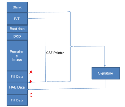

I have a question regarding to the boot data format of the bootable image.
The boot data is in the following format.
For the HAB signed boot, the bootable image would contains the additional HAB data.
Would the length entry of the boot data include the HAB data length or only the application image?
To be more clear, the value of the length entry of the boot code should stop at point A, B or C?
Thanks a lot.

The boot data the program image location, size, and the plugin flag. The secure boot adds some components to the program image.
So the boot data also includes the HAB data in secure boot.
If you have more questions do not hesitate to ask me.
