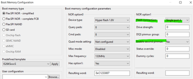

Hello, sorry for the late response, for test proposes could you download the SPT tool we will check your communication.
MCUXpresso Secure Provisioning Tool | NXP Semiconductors
Let me know if you have doubts.
