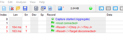

I tried the example lwip_dhcp_usb  (from SDK_2_10_0_EVK-MIMXRT1020) using several types of OTG USB cables (that worked with other devices/phones setup) on RT1020 connected to Samsung Note10 Android mobile phone. It appears that RT1020 running lwip_dhcp_usb  can't detect the phone; so the phone can't enable the USB Tethering.
On booting up, debug console displays only "Host init." and USB analyzer shows no activity

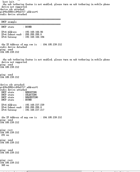

I tried this demo with my EVK 1020 board on my side, It can work on my side.
I would suggest you check your hardware settings.
Please refer to my settings.
