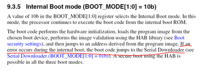

I'd like to have the same functionalities of SW8 on RT1020 EVK board; specifically the serial downloader (by setting SW8[3:4]=b01) mode can be used for manufacturing FW loading for 2nd bootloader + application + any data... via RAM flashloader spdhost & blhost utils. Then setting SW8[3:4] = b10 to continue XIP on flexspi flash.
If my custom board won't have the physical SW8 & its manual switching due to manufacturing procedure complication, what alternative could you suggest so that I can accomplish: loading the initial FW modules on external flexspi flash -> reset -> and boot XIP?
2,065件の閲覧回数
JamesNgo
It turned out there's a text in Reference manual that resolved the issue, where internal boot ROM will revert to Serial Downloader mode if external flash is empty or invalid.
