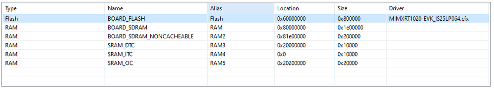

BOARD_SDRAM and BOARD_SDRAM_NONCACHEABLE are listed first and split 30MB : 2MB as described in that thread.

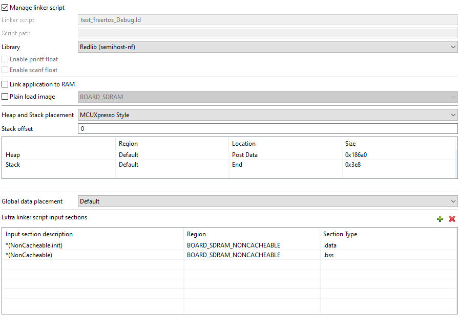

My memory details are quite standard:
Linker script settings have the BOARD_SDRAM_NONCACHEABLE extra section.
